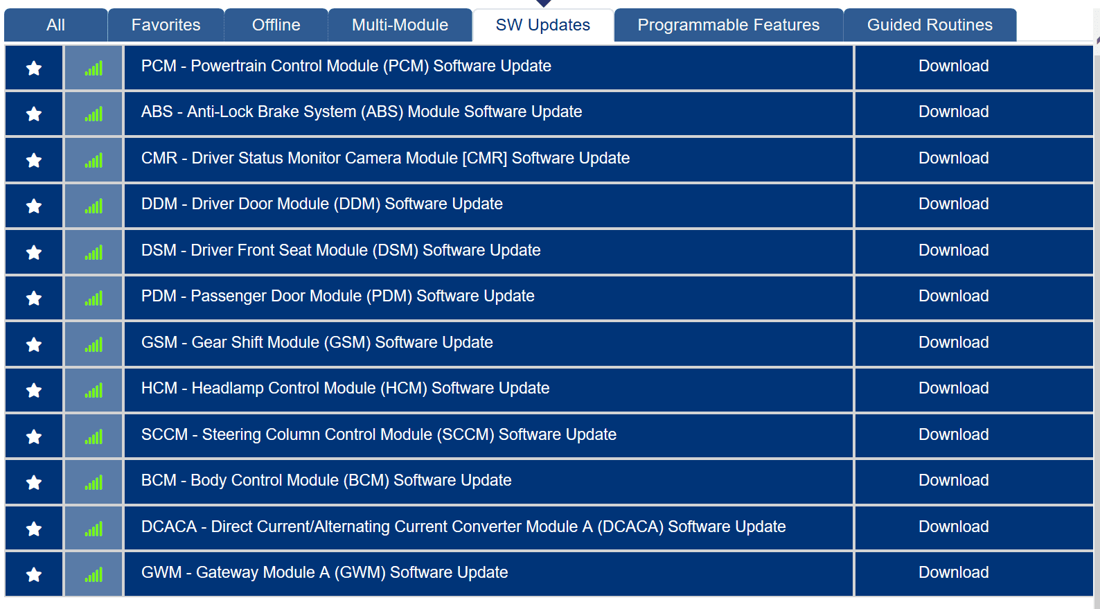

Im guessing BlueCruise Isnt working? They didnt update the CMR, Gateway or APIM.
They actually didnt do much of anything outside the IPMA update that took them a few tries. The CCM look missed, PSCM looks to be missed. The only way to get those done now is PMI them.
On top here are what is in FDRS for the truck
Yeah the truck won’t upgrade to 2.5.2 so no blue cruise. Not surprised to hear they didn’t actually upgrade all the modules (even though they claimed to). My dealership has gotten something wrong almost every time I’ve brought the truck in. Supposedly the technician from Ford is working with engineering to diagnose the issue and I should hear back from them soon.

@YzermanTopShelf
No,You will not have blue cruise as it stands now
They still need One gate way update and that should get you there. Also the APIM
