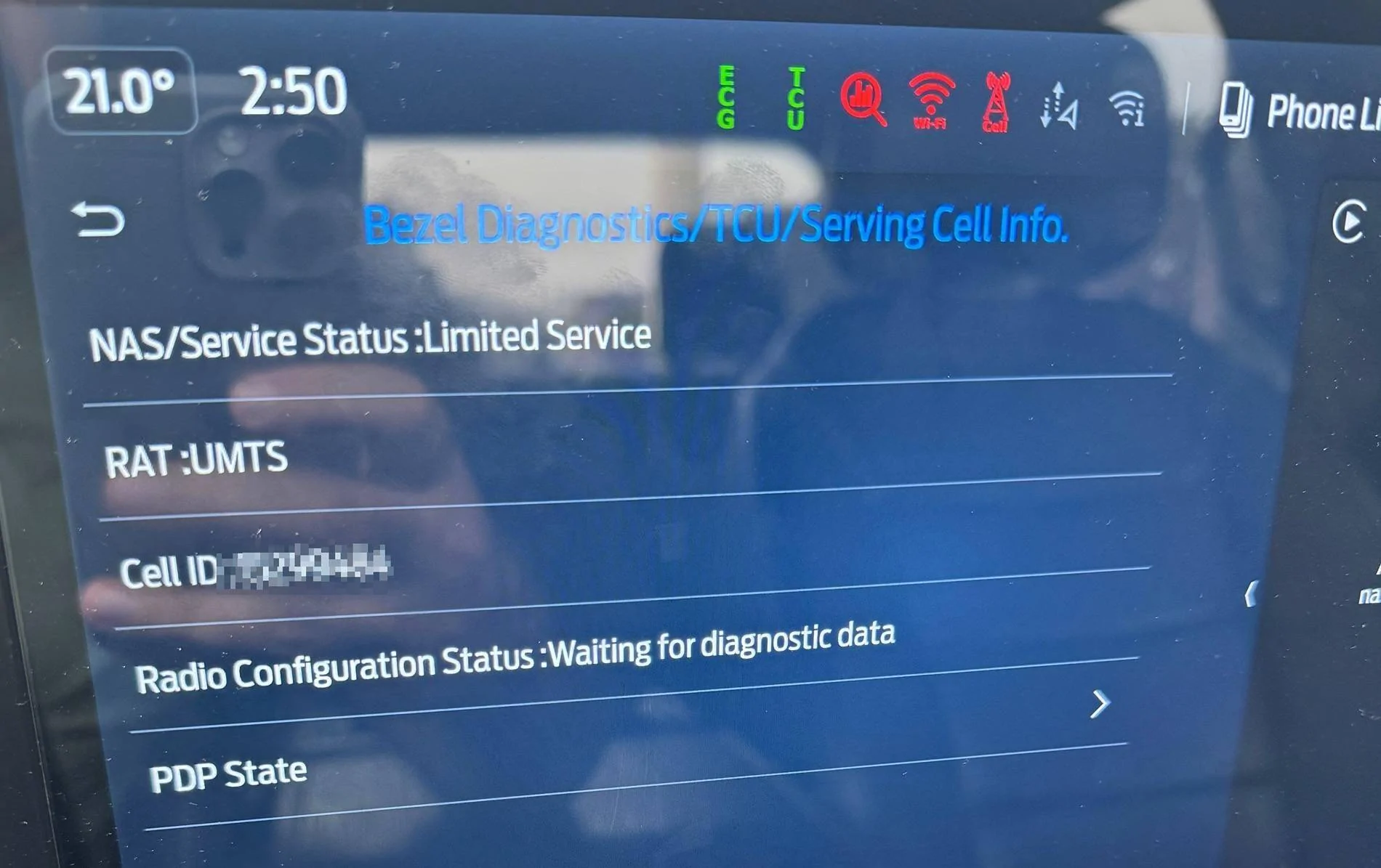

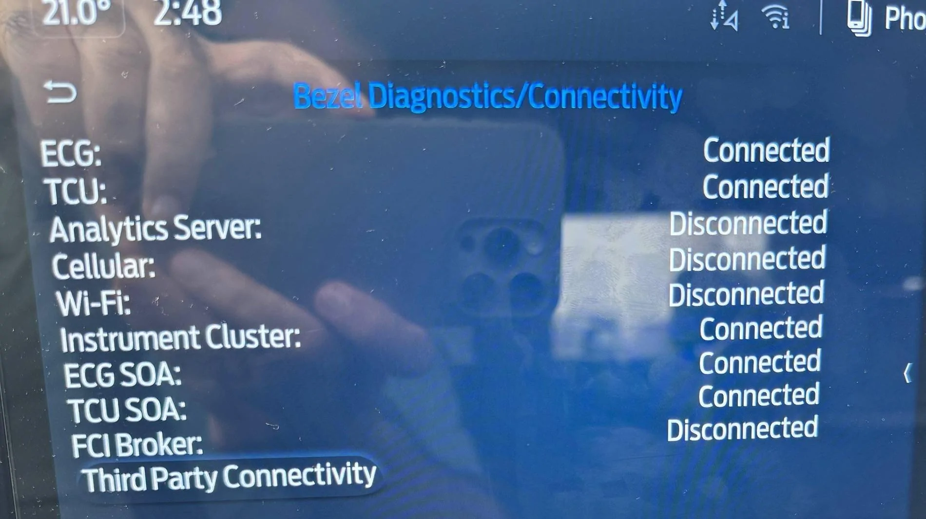

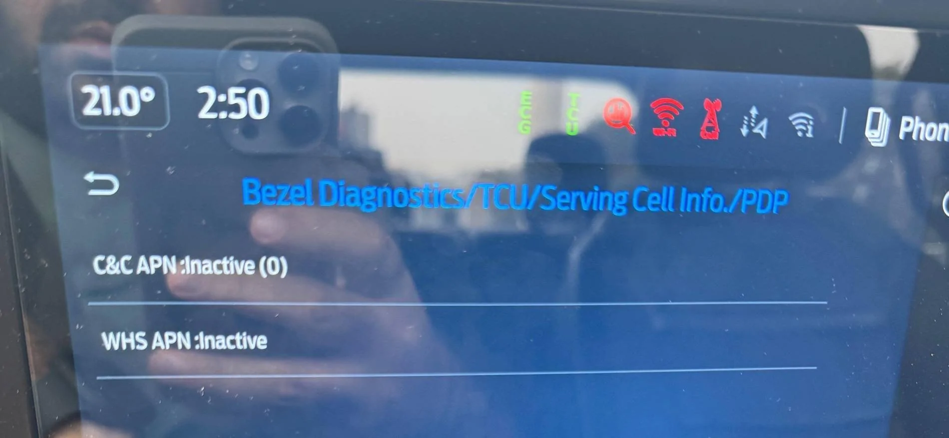

This is when the connection moves to 3G:
Ford F-150 Issues with FordPass 1741193841674-cm
Ford F-150 Issues with FordPass 1741193861039-oc
Ford F-150 Issues with FordPass 1741193885298-s3

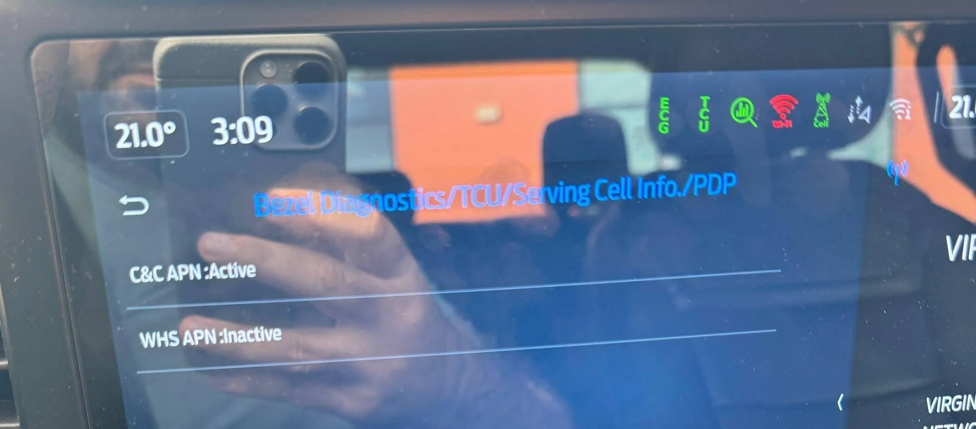

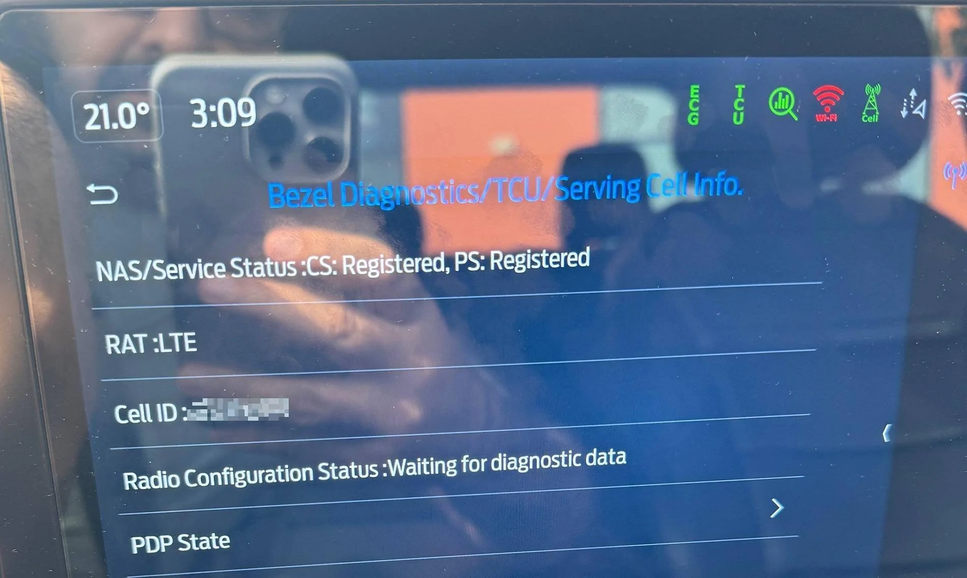

And this is when the connection moves back to LTE after doing the FP reset from the Sync settings:
Ford F-150 Issues with FordPass 1741193921502-9r
Ford F-150 Issues with FordPass 1741193935092-i0
Ford F-150 Issues with FordPass 1741193959932-wa
