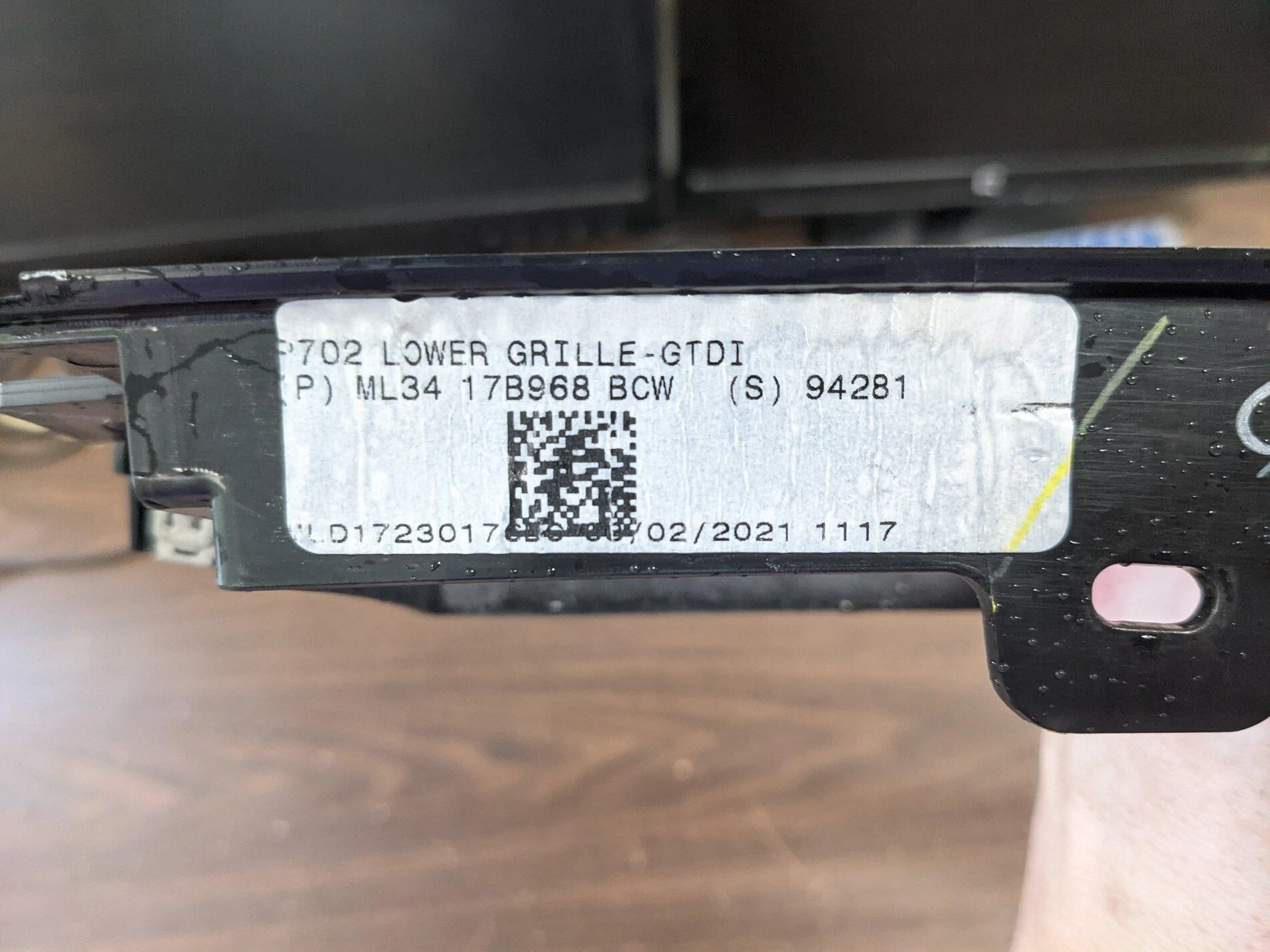

I just ordered part number ML3Z-17B968-BB to install the Ecoboost lower bumper center cover for my STX with a 5.0L so that I can install some pod lights in those gaps. The solid cover which comes standard on the 5.0L (without a block heater) is ML3Z-17B968-AB.

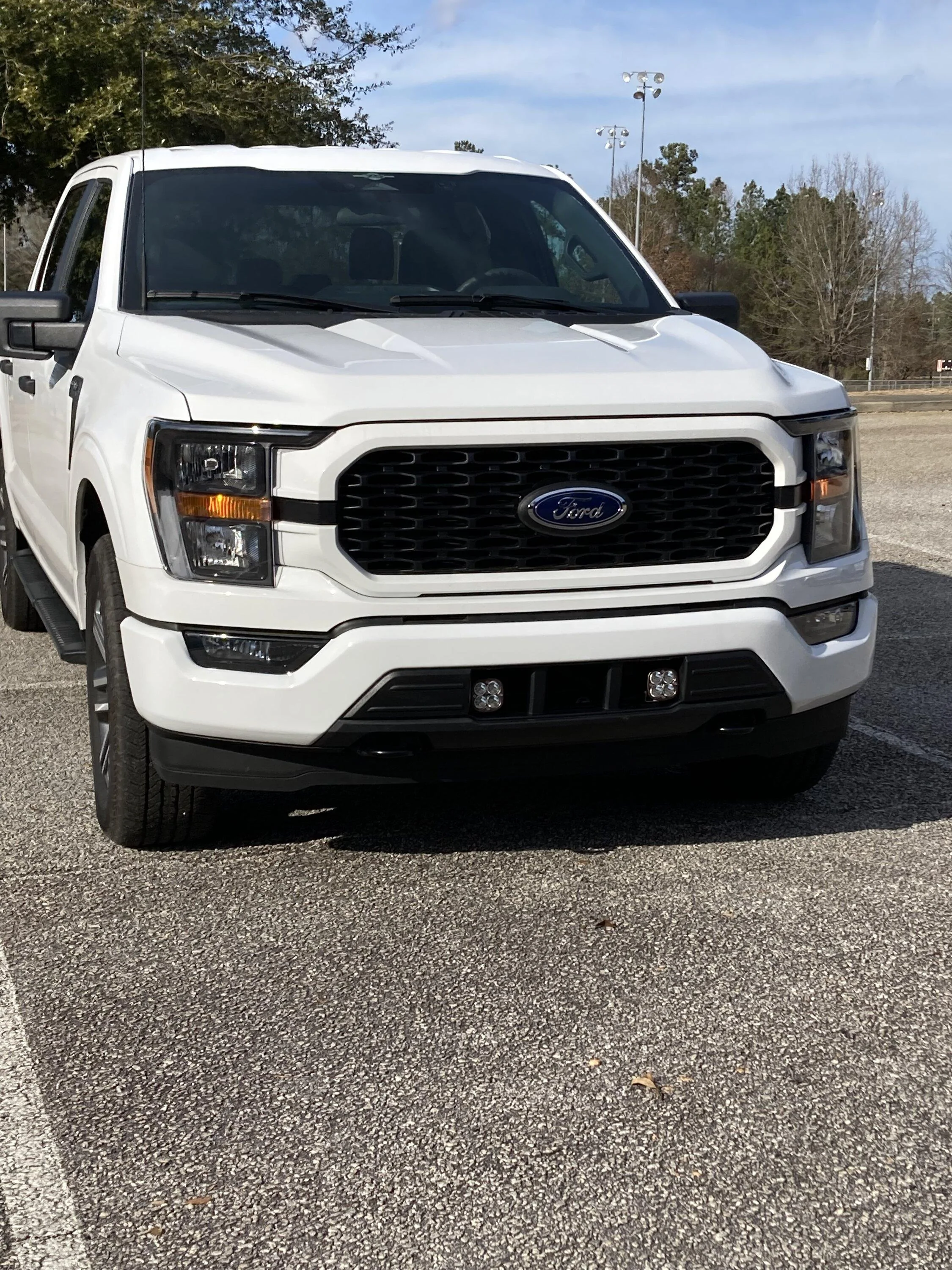

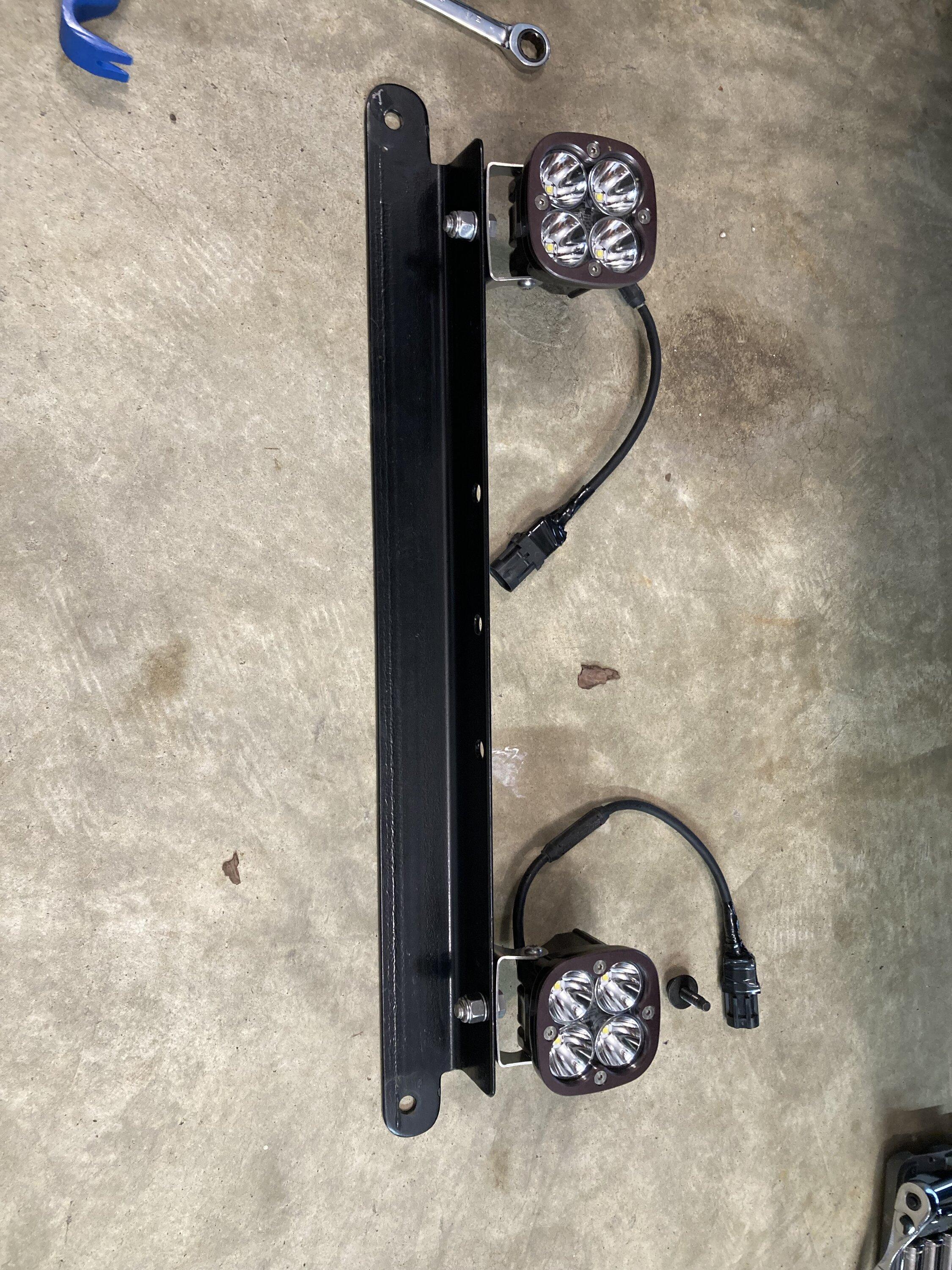

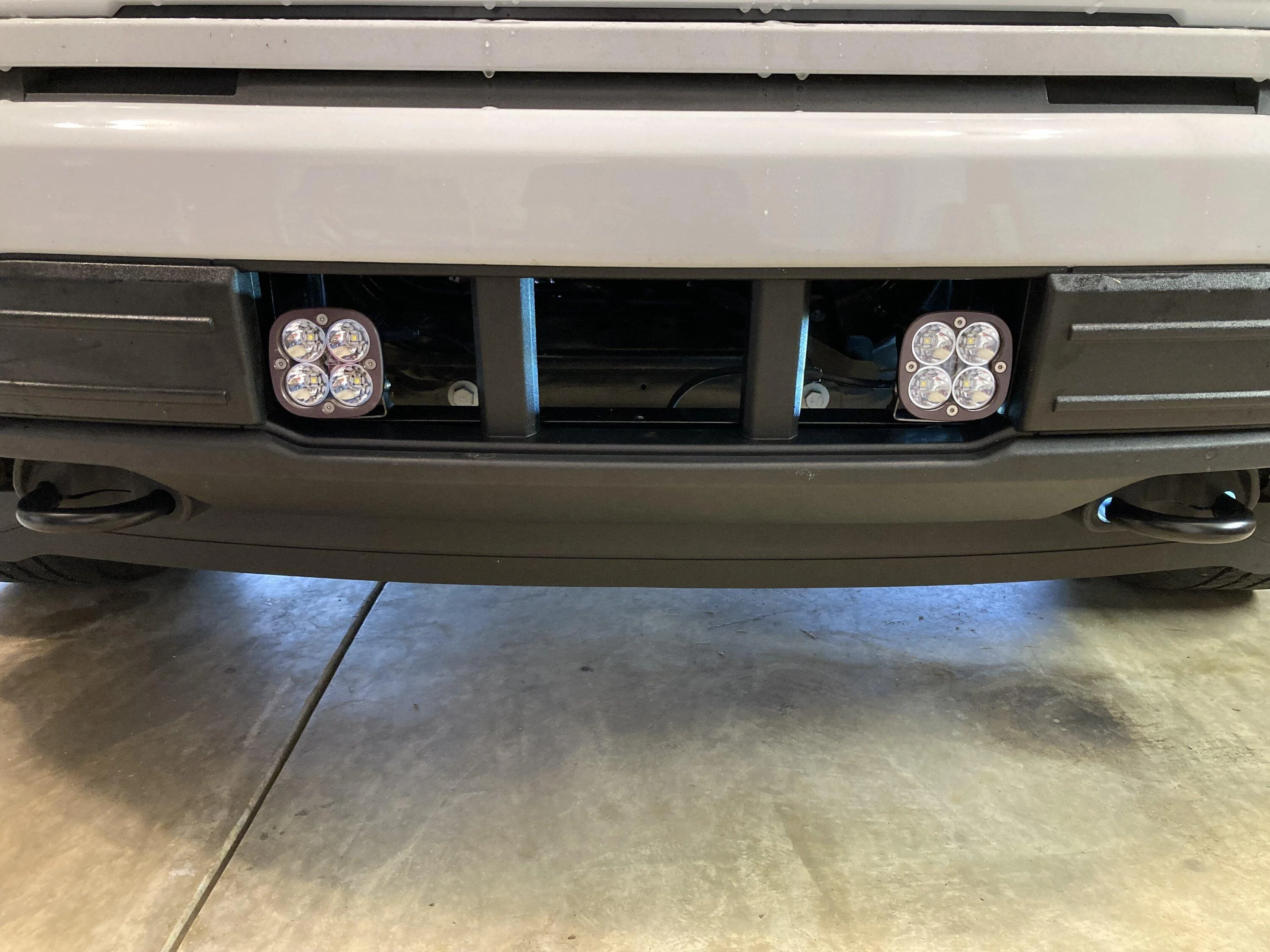

Got the EcoBoost lower center cover installed, along with some old BD Squadron lights and a custom bracket that I made from angle iron. Everything fits nicely. Power to the lights is with an Auxbeam 6-gang switch, wanted to future-proof for more lights at some point.
The hardest part was getting the lower plastic trim off, but once I figured out where the bolts and clips were, it wasn’t too bad.
