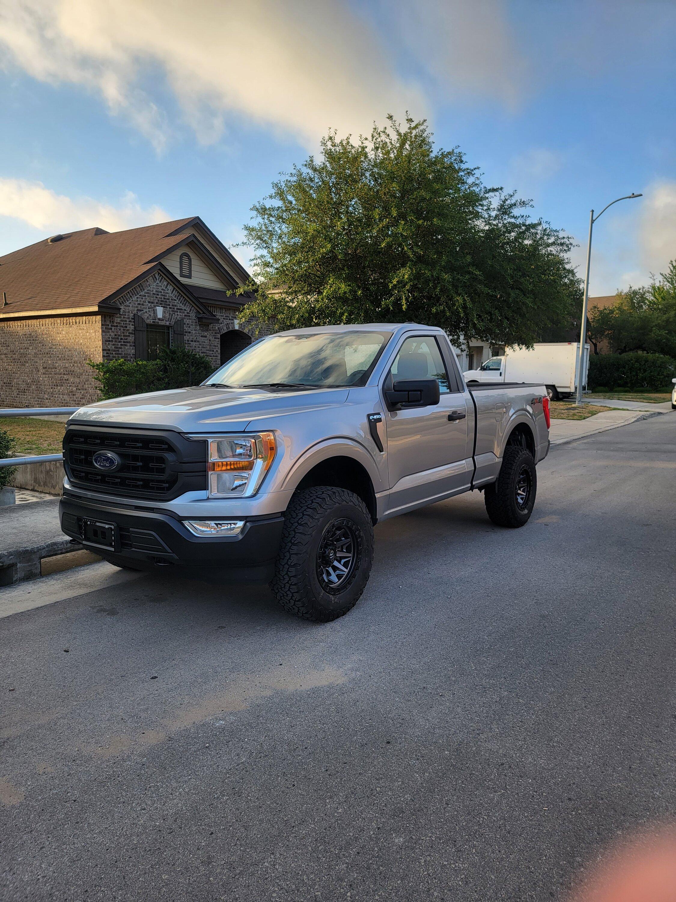

I got an e locker on my regular cab 4x4 (non FX4) with 3.73 gears.
Ford F-150 Is an E-Locker a must? 20220708_071829
My power plant is a 5.0 as well. She's a regular torque beast. I've used it 1 time so far in an off-road situation. (Only 2k miles on the truck) I know it made a huge difference. Also, people who use boat launches, tow trailers on the beach etc. benefit from e-lockers as well, especially if it's a non 4 wheel drive setup.
