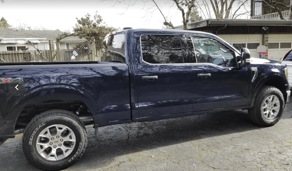

Its 2", unloaded the height from the bottom of the receiver is 20". Payload is 2,505 lbs. I have a 3.5 xlt HDPP with 18" wheel. Tow's like a champ.

Good info. Was looking for more hdpp payload #s so thanks. Hey Blue Beast do u have more pics of the..... blue beast?

That's the only pic I have. My payload is 2525 lbs. I shorted myself 20lbs.
