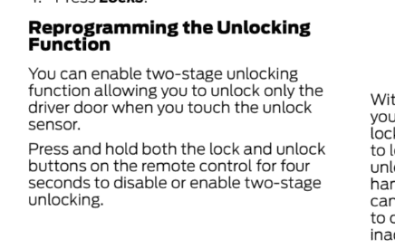

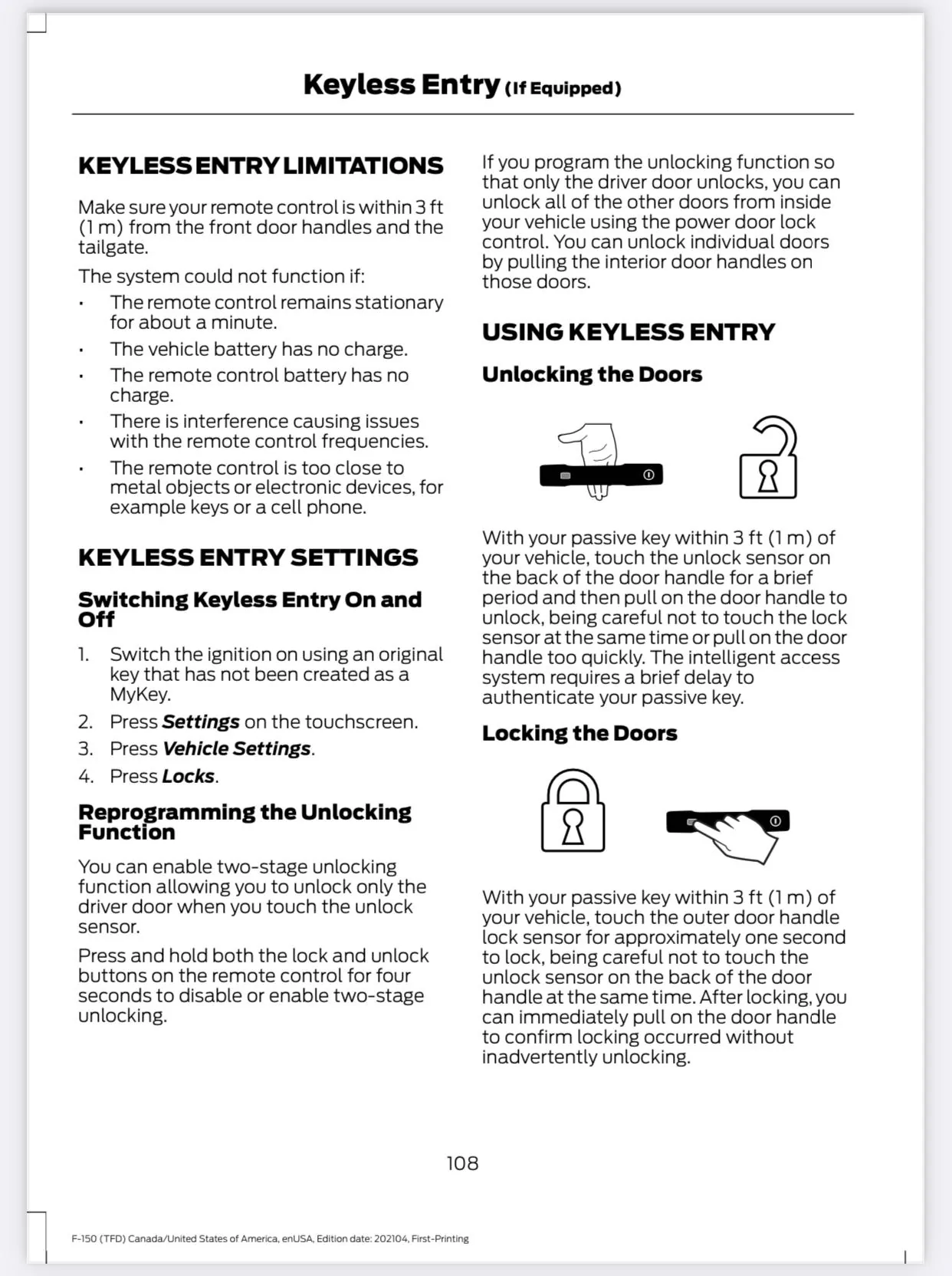

It's a setting, check the owners manual.

its a setting i think you access through sync. i believe you can just have the drivers door or all doors.

I guess I never realized until the other day but when I press unlock on fob it unlocks all doors on the first press. This happened now that I set the intelligent access to unlock all doors touching the handle.
