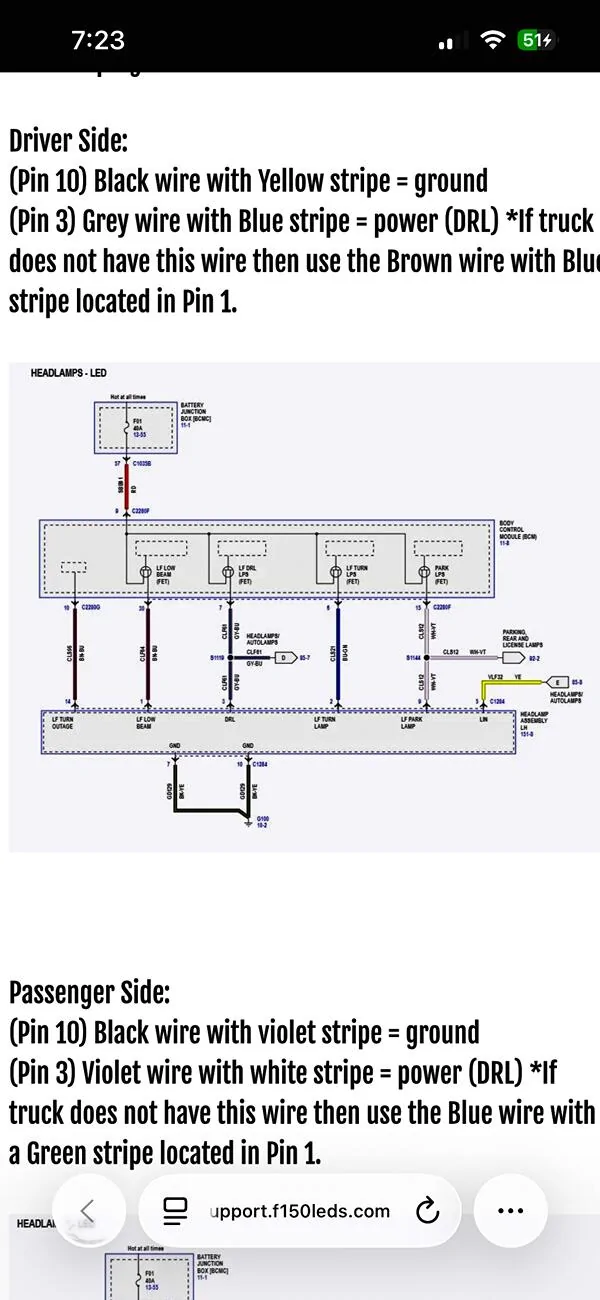

I have a 2025 F150 XLT in Canada. I’m trying to install the side vent lights from f150leds dot com.
I noticed the 2024+ wiring PDF for the side vent lighting kit, and it says to modify from the video and connect to the DRL instead of the side marker.
As far as I know, the DRL will turn off at nighttime when the headlights turn on, therefor the side vent light would turn off.
So is this really the proper way to install this? Or is there a better way?
Is there a reason the PDF instructions for the 2024+ state to not use this method, and instead use the DRLs?

Okay, I had to go back and read the directions again. It's been a minute. If you have LED headlights on your XLT then you have to modify it and wire it off of the headlight DRL wiring. If you have the reflector halogen headlights then you get to wire it off of the side marker light.
So do you have LEDs or are they halogen headlights?
And I had a Toyota Tacoma from Canada, and the DRLs never went off while I was driving that truck. So I find it weird that your truck would turn off the DRLs when you're driving or when you turn on the headlights. I know the laws in Canada are different than they are in USA for the DRLs.

I didn’t have a pin 3, DRL. So the manual says to install to pin 1, which is the low beams.
so they do not turn on with proximity. And only with the low beams.
would I not be better off installing them to the parking lights in pin 9??

You better call them up and talk to them. The difference is that your in Canada and your laws run your lights different from ours.
But in mind yes, wire off that wire instead. You can't put anymore on that circuit though.

What do you mean I can’t run more off what circuit?
They have been trying to be helpful. But to be honest they haven’t done it before either and don’t know. They said I could try the parking light wire. But unsure.

If you put any more wires tapped on that circuit it could overload it and cause the canbus wiring system to kind of go nuts on your headlight. The computer can see too much voltage being drawn away and throws a flag up in the computer system.
But its like you have them hooked up. I'm guessing they only work when the headlights are on, correct?

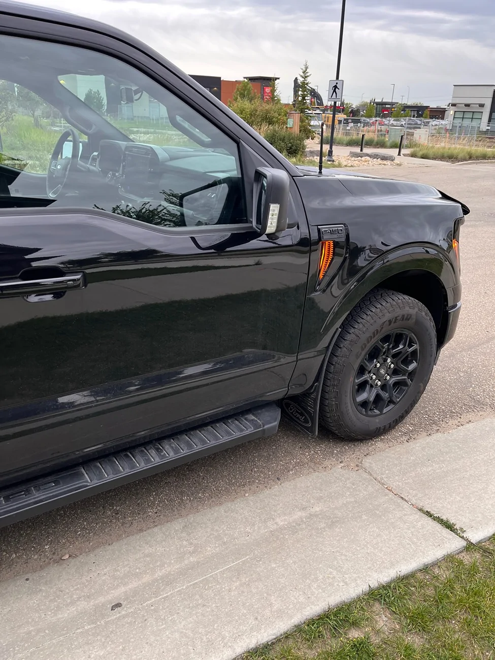

FWIW, I ended up going rouge and looking through the wiring diagrams myself. Ended up hooking it to another connector in the front for the parking lights.
Now they come on with proximity, unlock, and anytime the vehicle is running. Perfect!

Not sure on the connector name, but it’s a two wire connector next to the main headlight one. It connects to the side marker light.
