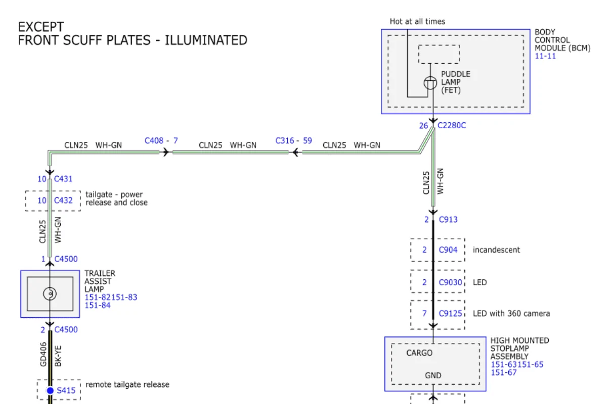

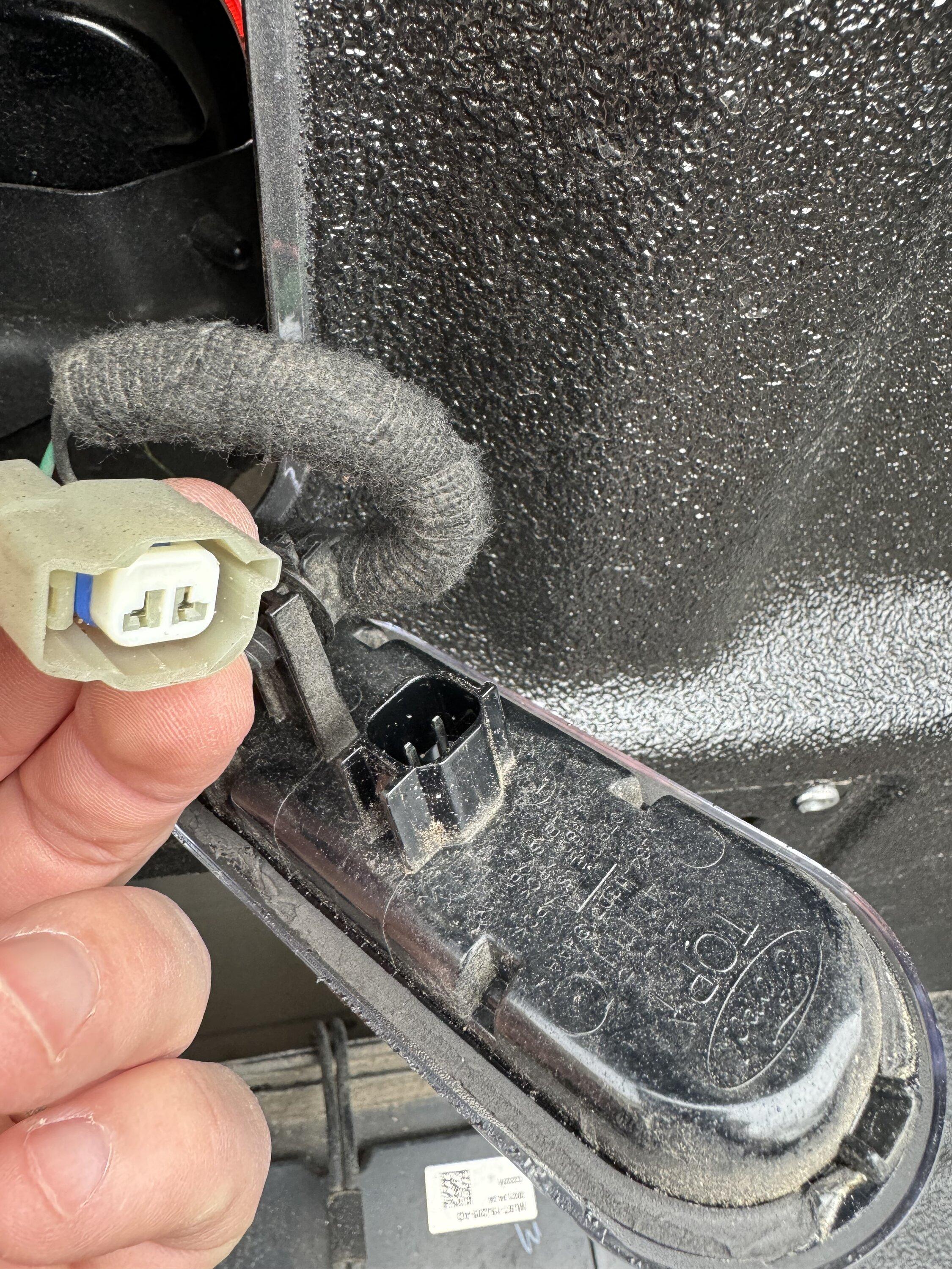

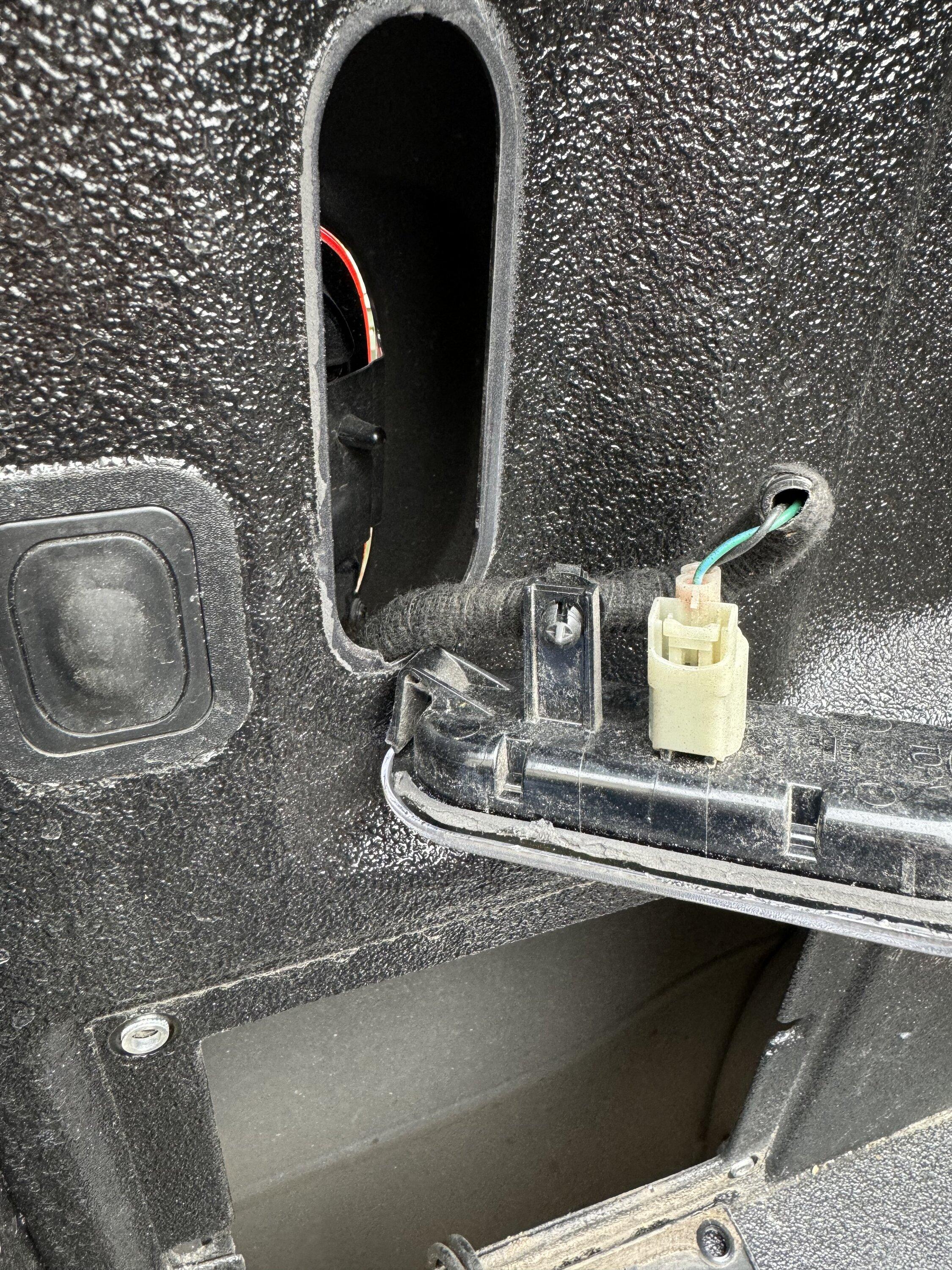

hoping someone can help. i have a 23 xlt without bed lighting but harness for the lights are installed. i installed OEM lights and harnesses. i set all the forscan setting for bed lighting i could find in the BCM does anyone have the settings for this feature?
