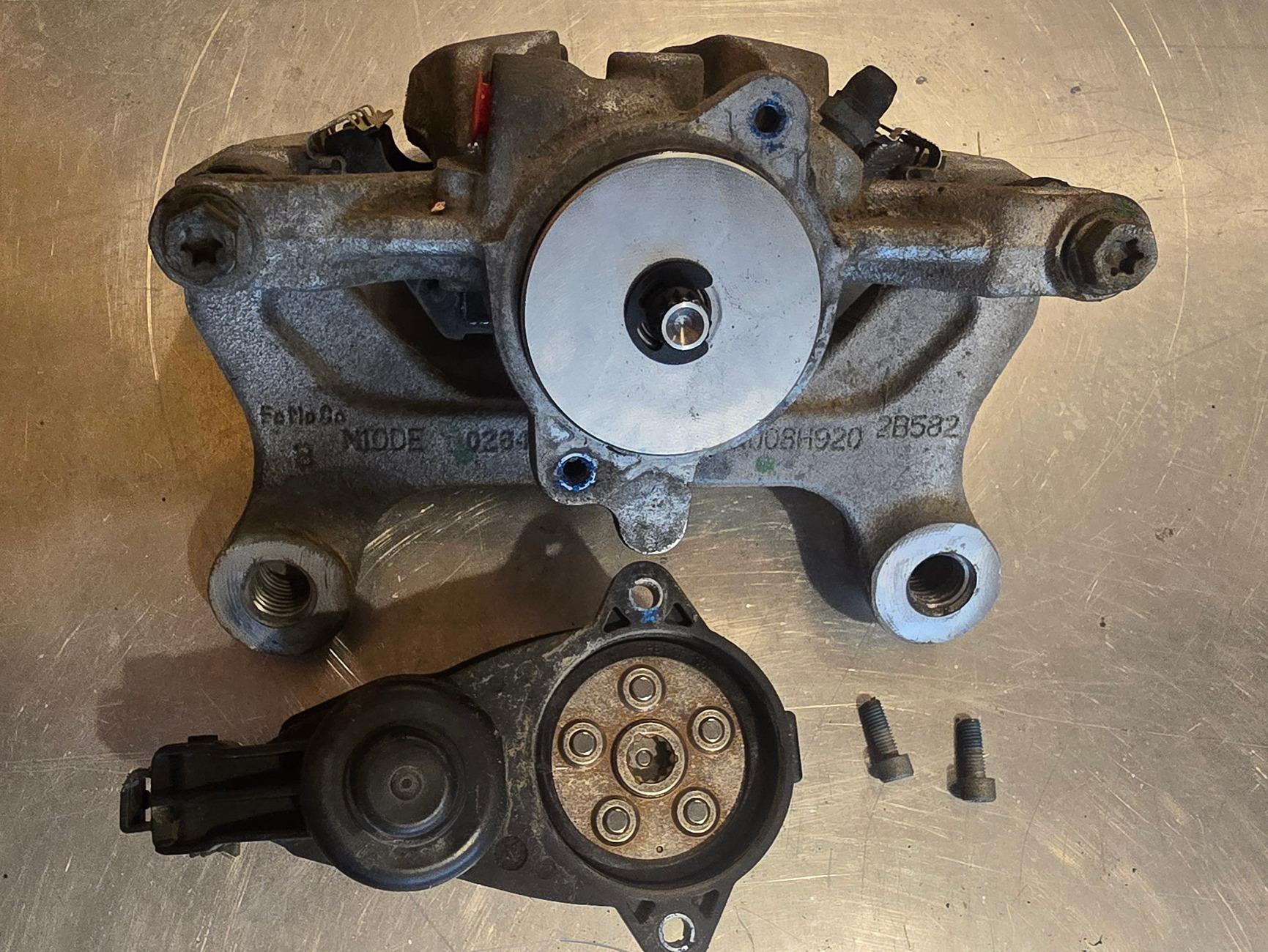

Oh for others watching, be very careful of your electric parking brakes (EPB). There is a procedure to put your EPB in maintenance mode. I was unaware of this at the time I did my LSD, but I'm used to disconnecting the battery anyway. If you disconnect your battery (like I did) be sure to remount the rear calipers *before* you reattach your battery. When you reconnect the battery the truck will wake up and test the EPB causing the rear caliper piston to over extend, pop out and leak fluid everywhere. I wondered if there is a way to recover from over extended caliper pistons but I couldn't find an honest way to do it short of replacing and bleeding new EPB calipers. It's best to just be aware and careful.
You can retract them by disconnecting the plug and pulling the two T30 torx bolts that hold the electrical mechanism onto the caliper. Once the mechanism separated, just spin the gear on the caliper clockwise until it is in the fully retracted position and reassemble. You will need to put pressure on the pad while turning the gear. I suggest opening a bleeder so the fluid from the caliper does not go back into the lines. I took a photo of a caliper so you could see what I am talking about.
