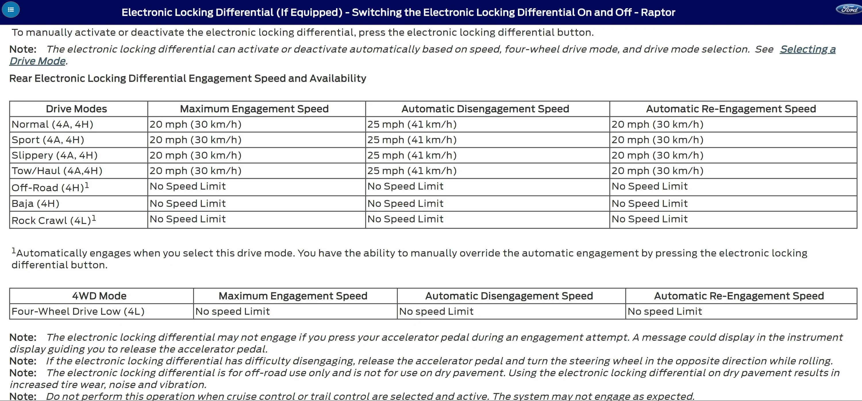

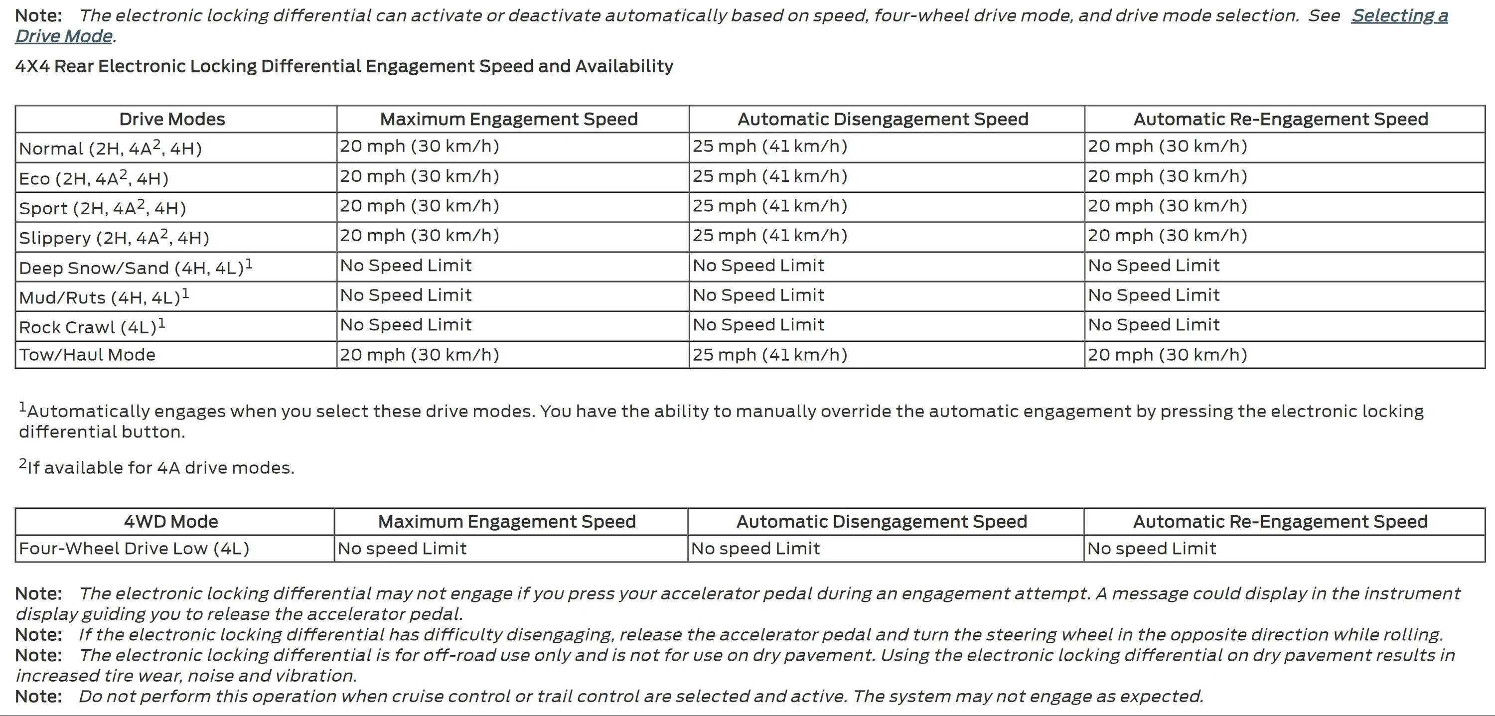

I would have answered the same, but I was away for the weekend. ? Here is a page from the Ford owners manual that may be helpful as well.
Ford F-150 Installing a Trac Lok or Eaton Truetrac for a Super 8 (8.8) ELocker
One other thing... According the the owners manual, the Raptor is not much different than the other F150's. The deactivation point isn't any different in normal mode. Here is the Raptor E-Locker page:
Ford F-150 Installing a Trac Lok or Eaton Truetrac for a Super 8 (8.8) RaptorELocker
