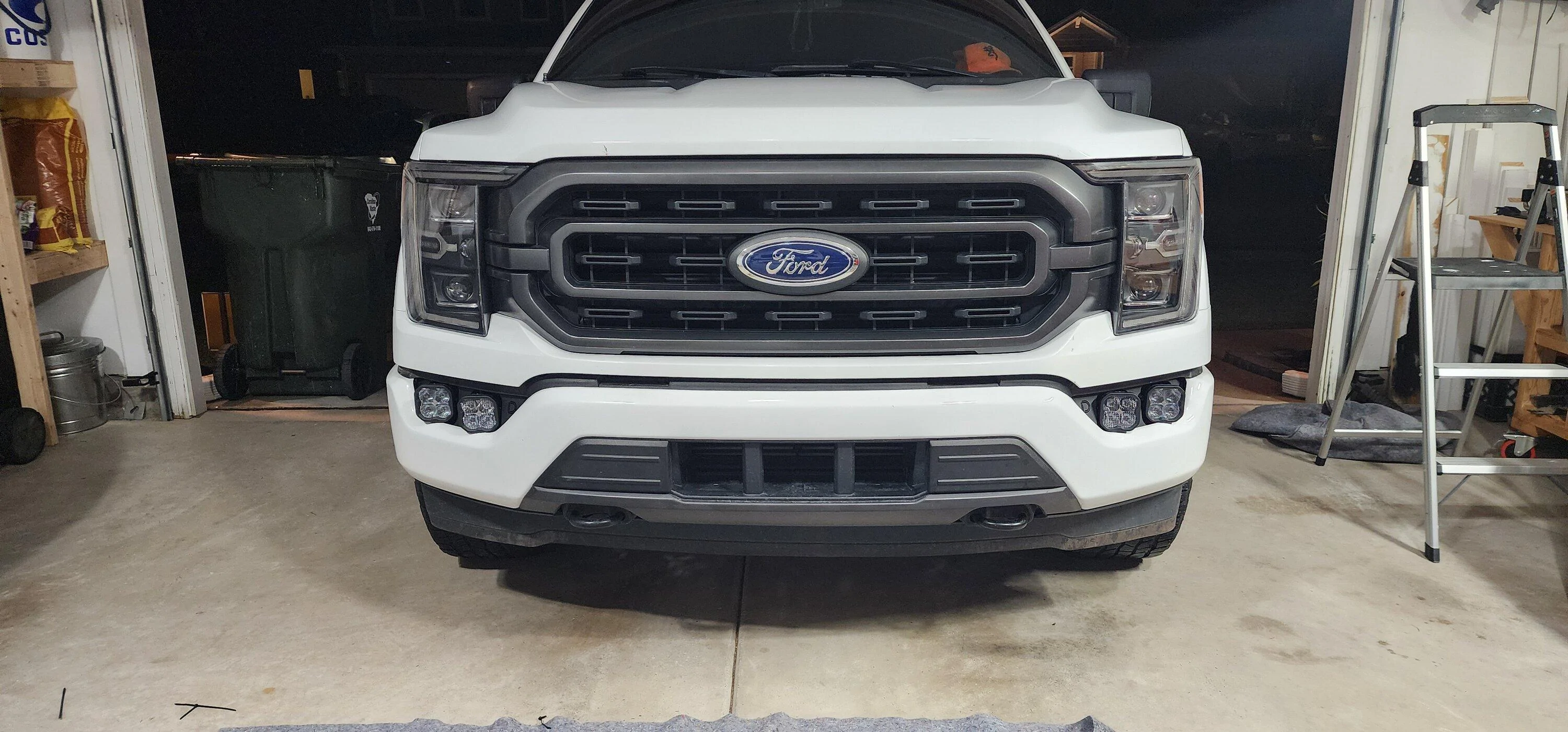

Finally ordered and installed the @Diode Dynamics Fog Pocket Kit on my 2021 F150 XLT Sport.
I'm very happy with the output and the kit appears to be well built. My only real con with them is adjusting them once they're mounted and tightening the screws on the inside bolts. I had to cut an Allen key to a stub but was eventually able to get them to tighten down. The install was rather easy, running the wiring harness through the firewall into the cab for the switch for the off-road pods was a royal pain. I did install the pods different from DD instructions; I put the off-road pods closer to center and the fog lights on the outside. I wanted more spread on the outside and I'm happy with it. Figured if I didn't like it I'll switch them around.
Pictures below of the looks and the light output.
Whole bumper removal required.

I went with the Sport/Cool White.
I also didn't install the ambient lighting feature. I just taped off that portion of the harness. To me it looks tacky...If the ambient light had a subtle white light I would've prob rigged them up.

I ended up cutting the ziptie off the wiring bundle on the engine side and under the driver footwell. It loosed up quite a bit. I then took some solid 10ga wire I had laying around and was eventually able to feed it through.
My 2009 RAM I had back in the day was convenient...it had two extra accessory ports on the driver side and one on the passenger side. Ford made it about as difficult as one could imagine haha.

Are they off-road use only? Looks like you'll be blinding oncoming drivers.

Is the light output more then the stock XLT stocks ?
Absolutely. I had the base halogen fogs but I had replaced with LED bulbs, and even adjusted them up because ford aimed them like crap...they were bright . But these are on a whole different level.
The picture with the low/fogs are road compliant and haven't been flashed yet. If I flip the switch to the two inner pods those send more of a straight beam for trails/ off road use. Those would blind oncoming traffic but I'll flip the switch on/off as i need. But the two outter pods come on with my headlights just like the stock fogs did.
I adjusted them to the height level that DD recommended.
