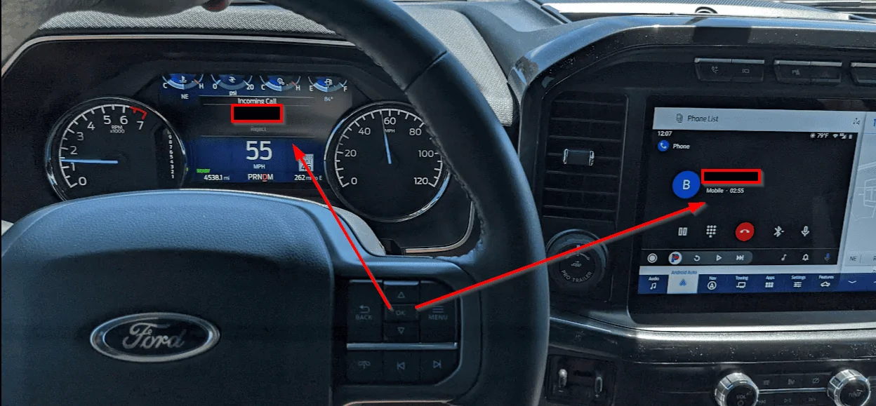

This happens to probably most if not all incoming calls. I click accept on the 12" center stack and the pop up in the dash won't disappear until the call disconnects. I am able to toggle between accept and reject using the up/down buttons, but the OK button doesn't do anything. I usually don't notice the dash popup until after I accept calls via the 12" center stack.
Nov 21 build, Android Auto, factory software all around, nothing has been updated via OTA, Forscan, or via dealers.
See below example of being in call for 3mins and dash popup still there.
Anyone else have this issue ?

I had this issue the other day. Answered a call via the 12" display and the pop-up on the cluster didn't clear. It was unresponsive to pressing buttons after the call ended. But it cleared on its own after a couple minutes.. This is the first time I've had the problem.

Ford had a special service message for various Sync problems when a contact in your address book has unrecognizable characters or emojis stored with the contact info. A fix was pending a few months ago but Ford said to delete any of these until a permanent fix was released. Most users with us concern would experience a black or frozen screen after a call or text message is received from the contact in question.

Not sure when it happened, but a recent OTA appears to have fixed this. Have not had this problem in the last few months and have had lots of incoming calls. #fixed
