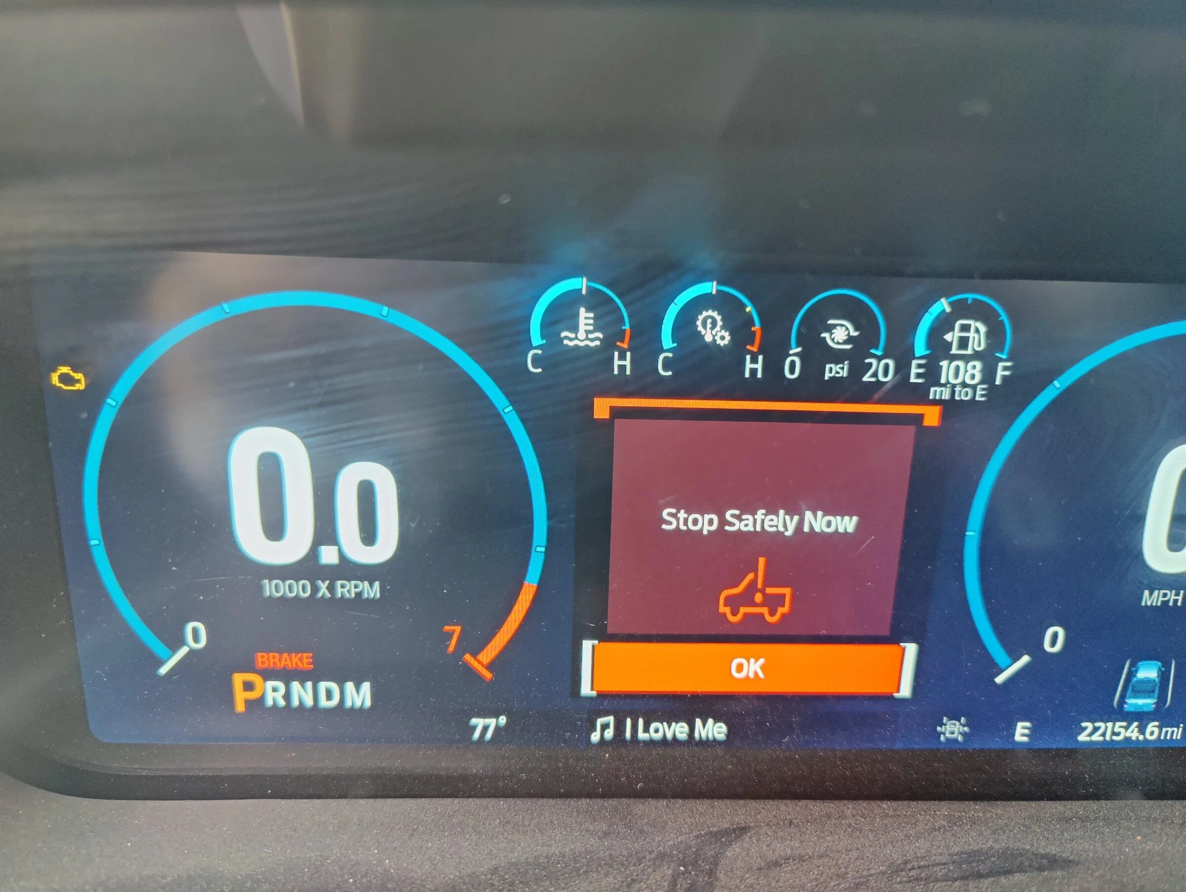

Driving from Mesa to Flagstaff today in the 2021 Powerboost. 1240 feet elevation to 6909 feet in 75+ degrees. About 20 miles out of Flagstaff it all broke loose.

Ford F-150 I think every control module overheated. Screenshot_2022-05-28-16-11-41-61_08e83652dfc77be23f13f5cffe10fb33
Ford F-150 I think every control module overheated. Screenshot_2022-05-28-16-11-49-20_08e83652dfc77be23f13f5cffe10fb33
Ford F-150 I think every control module overheated. Screenshot_2022-05-28-16-11-53-85_08e83652dfc77be23f13f5cffe10fb33
Ford F-150 I think every control module overheated. Screenshot_2022-05-28-16-12-00-74_08e83652dfc77be23f13f5cffe10fb33
Ford F-150 I think every control module overheated. Screenshot_2022-05-28-16-12-11-70_08e83652dfc77be23f13f5cffe10fb33
Ford F-150 I think every control module overheated. Screenshot_2022-05-28-16-12-20-44_08e83652dfc77be23f13f5cffe10fb33
Ford F-150 I think every control module overheated. Screenshot_2022-05-28-16-12-31-79_08e83652dfc77be23f13f5cffe10fb33
I was able to limp into Flagstaff and park at the Ford Dealer but they are closed until Tuesday.
When I shut it off it would not turn back on. About 30 minutes later it was able to start back up. Not sure if we should try to go to Vegas tonight.
