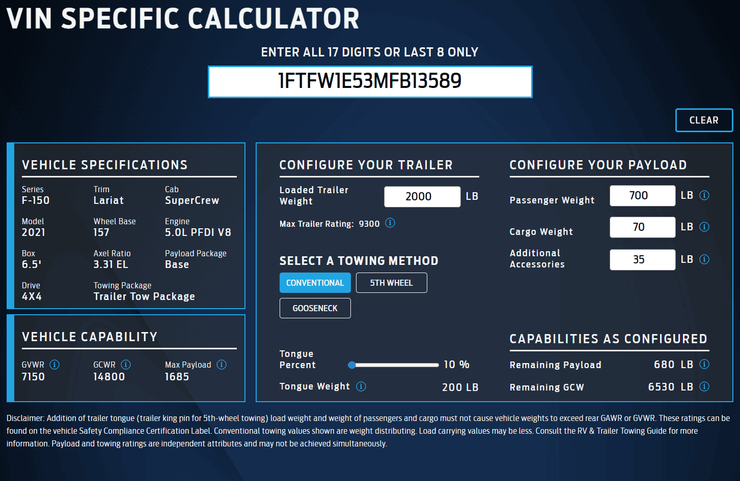

Software
This was my 2021 2.7L and me just playing around with towing my tin boat. Obviously, OP would need to punch values in for their needs, but sharing as general FYI.

This was my 5L playing around with towing his tin boat. lol

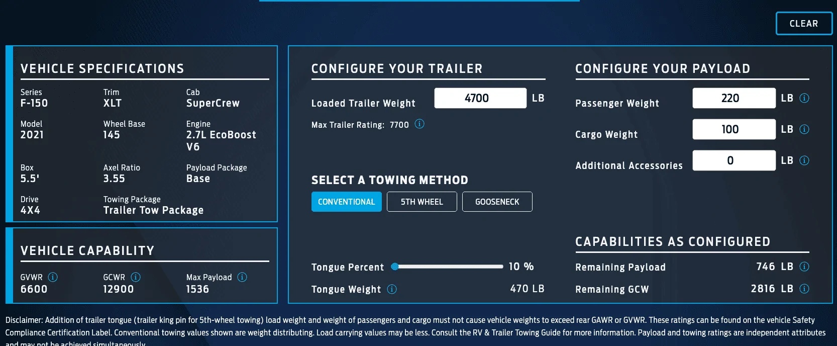

I actually had used the calculator previously, but again - I'm not 100% sure exactly what to do with the returned values. It offers confirmation that I'm within the limits of my truck's towing specs, but the tongue weight remains somewhat of a mystery to me.
The input values below are conservative; I've toyed around with a number of payload/cargo numbers. The 10-15% tongue weight calculation is pretty obvious... what's less so is what exactly do I DO with that value? Since the tongue weight percentage is adjustable, it stands to reason the value is a suggested value (what I NEED). So, if I'm understanding it correctly, the million-dollar question is "how do I measure/adjust tongue weight????". Comments above, and on other threads, suggest to simply "weigh it"... I do NOT intend to sound sarcastic here, but how the heck does one weigh a vehicle/trailer in ANY capacity, let alone specific areas of them?
Ford F-150 I might be "THAT guy"... payload copy
I did order a wdh with a friction sway control bar. The reasonable cost and overwhelming consensus that it's a sound addition were enough to convince me it's a worthy investment. I also appreciate those who have pointed out that just because I haven't recognized sway as a noticeable issue doesn't mean there isn't a benefit and/or less potential for running into an "oh crap" situation in the future. I've done quite a bit of research on the installation/configuration of the WDH, and the concept & procedure seem clear. The only caveat I foresee is that since my driveway has a 5-6 degree grade, I'll need to move the trailer for installation (no biggie).
I'm eager to see what type of improvement the weight distribution and sway bar yields, although it's obvious I still have some research to do in order to fully grasp the tongue weight concept.
