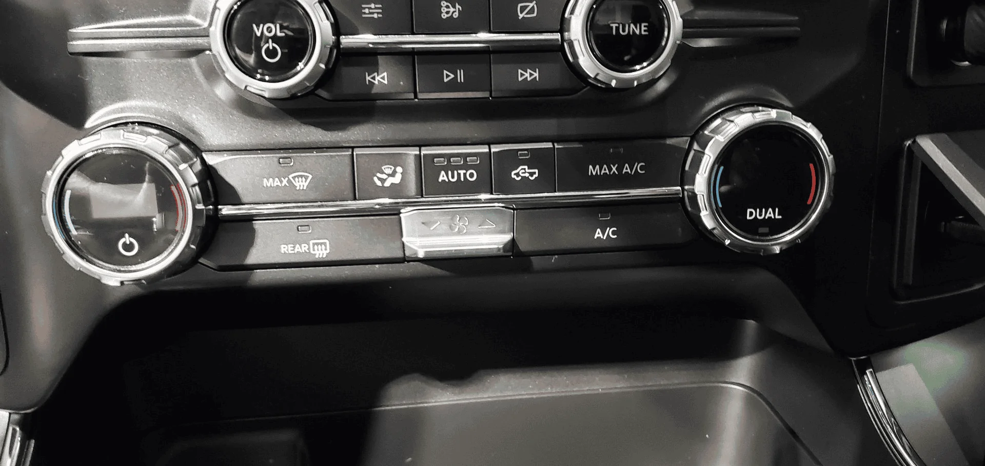

IS there a way to show fan speed settings on the 12" display when you are toggling up and down? Right now when I toggle I only know know by sound if it's increasing or decreasing in speed. My truck is originally an XL that had an interior upgrade done.

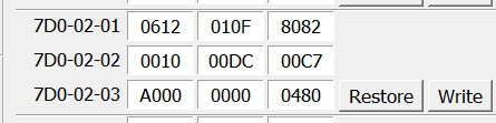

I went through the non AS BUILT format and was able to locate it that way easier.
Ford F-150 HVAC controls. Fan speeds not showing 1691408154632
It was disabled so I enabled it
Ford F-150 HVAC controls. Fan speeds not showing 1691408207117
Now I can see! lol
Ford F-150 HVAC controls. Fan speeds not showing 1691408275341
Thank you!!!

The forscan short cuts are nice and easy. The direct change would have been 010F gets changed to 010E to turn on the fan repeater.
Yes. The short cuts are much appreciated especially as I am completely new to Forscan.
Now, seeing that second row value 010F is disabled and 010E is enabled helps.
