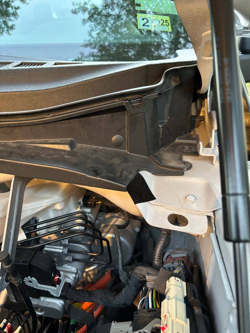

I got my truck back 10/18 after being at the dealer for eight weeks. The noise is gone. The fix was to put felt tape between the lower left edge of the wiper cowl and the metal firewall. I will try to attach photo.

This is all I can see without taking off the cowl. There may be more tape under it.
