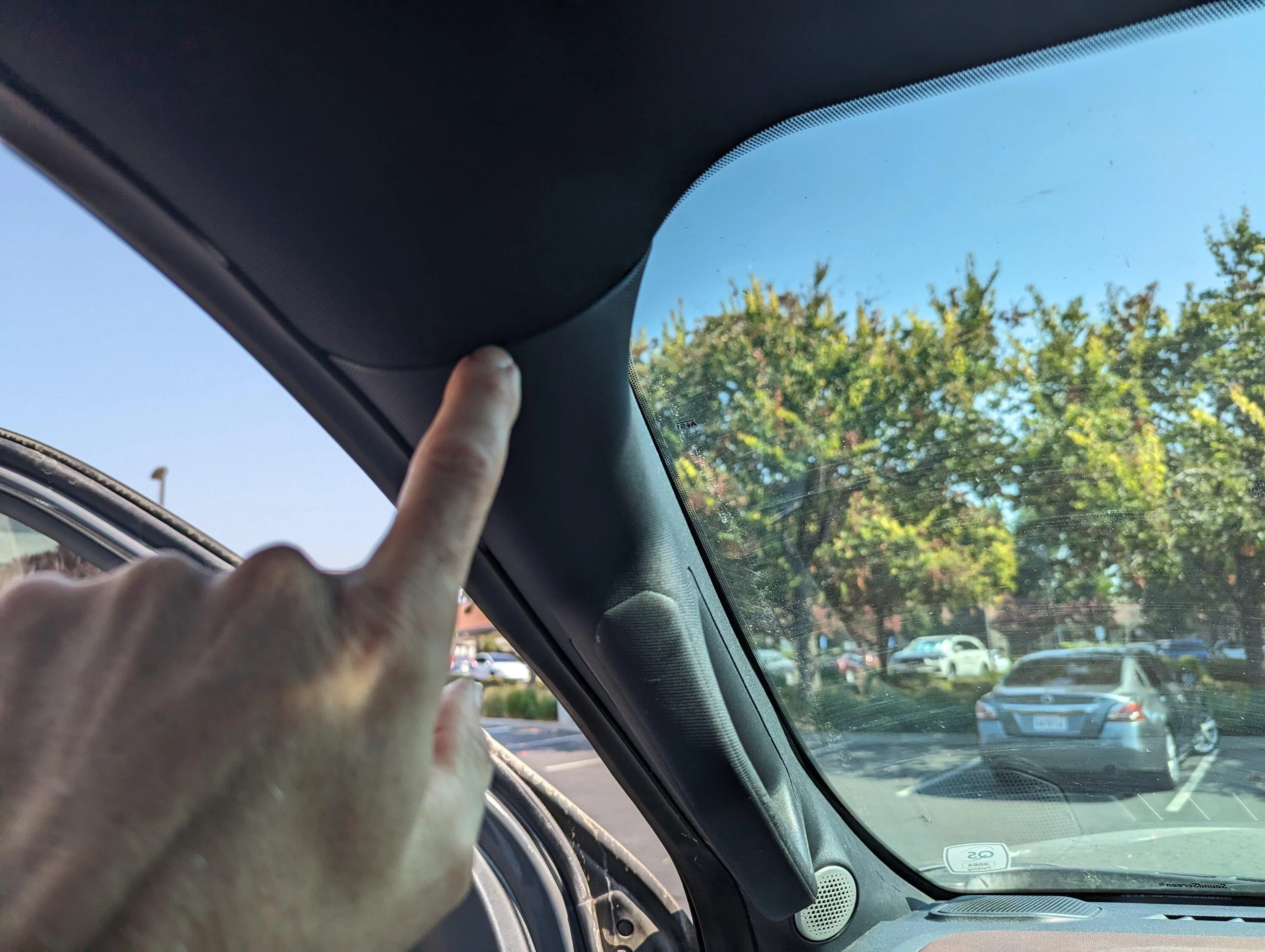

I put the camera in the middle with the lines going into the headliner.
Ford F-150 How to remove all stored power PXL_20230920_212927026
Then I poked it in going across the window.
Ford F-150 How to remove all stored power PXL_20230920_212941671
Then into the crack here.
Ford F-150 How to remove all stored power PXL_20230920_213004453
Then down behind the door seal.
Right along side the airbag and it didn't complain.
Ford F-150 How to remove all stored power PXL_20230920_213016166

i used a daisy chain connector to the USB port that leaves me a port to hook up forscan or scanners
no need to unplug battery
ran wires across headliner like above and down the a pillar
the camera in back window i fished teh cable for it through headliner around pano roof stuff
