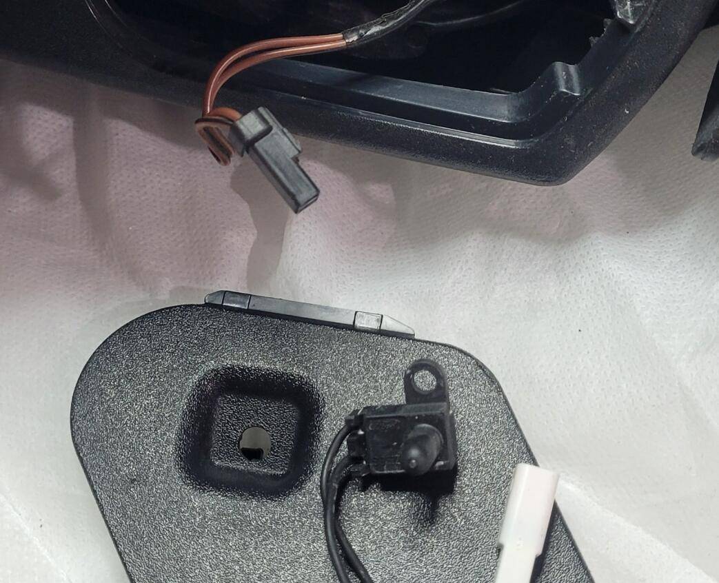

Still digg'n boys, I'll figure it out
Here's your 'temp sensor' it's the nub on the bottom of the passenger mirror

Unplug mirror motor
