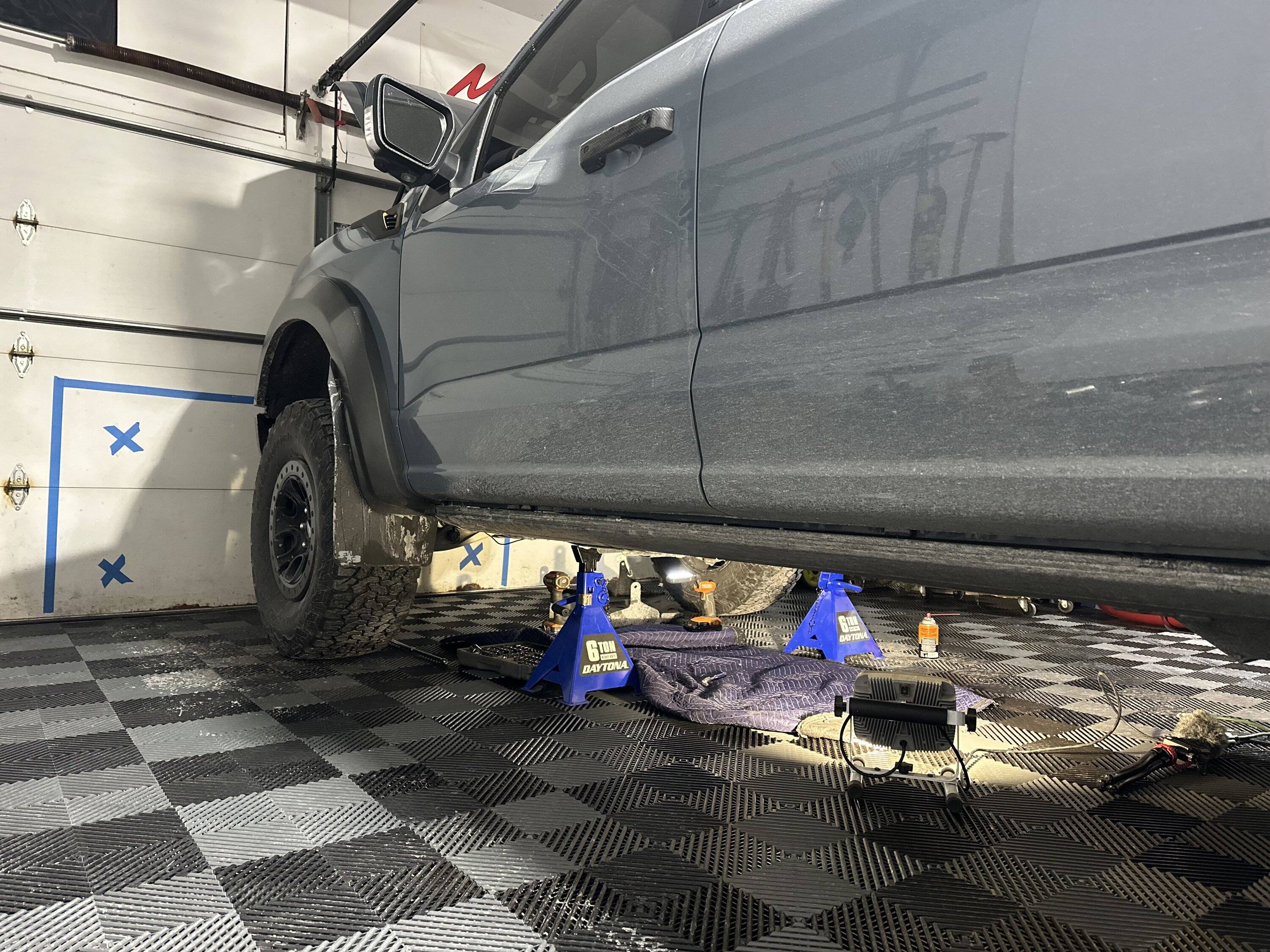

Alrighty! Here’s a walkthrough on how to swap out your favtory downpipes with the CV Fab pipes. The kit I installed in this video are prototypes but I would assume the production kit will be nearly identical.
Overall the project is pretty straightforward and took about 4 hours start to finish by myself.
At 17 min I cover some tools that I would recommend having before diving into your project.
Skip to 20 min mark for the before/after sound clips.
Ford F-150 How to install CV Fab Dowpipes (w/ before/after sound clips) IMG_5526
