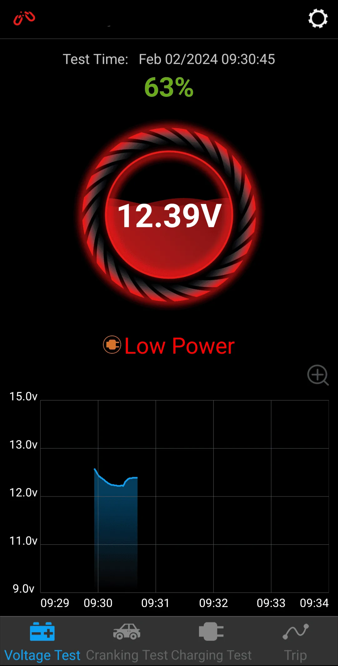

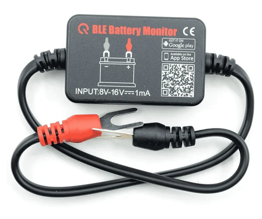

Another option to monitor the battery is the BM2 that a lot of us here use. It's hardware that sits on top of the battery and connects via Bluetooth to your Apple or Android phone. Very small current draw when F150 is off. Monitor battery voltage at anytime within 10 ft of truck. I can do it inside my house.
QUICKLYNKS Auto Battery Monitor BM2 Bluetooth 4.0 12V Device Car Battery Tester https://a.co/d/gDIXh01
Ford F-150 How to install a permanent trickle charger on new F150 Lariat 2023. Also how can I have the Battery/Alternator level on the screen steering wheel? Screenshot_20240202-111717
From the app, my current battery voltage with truck off.

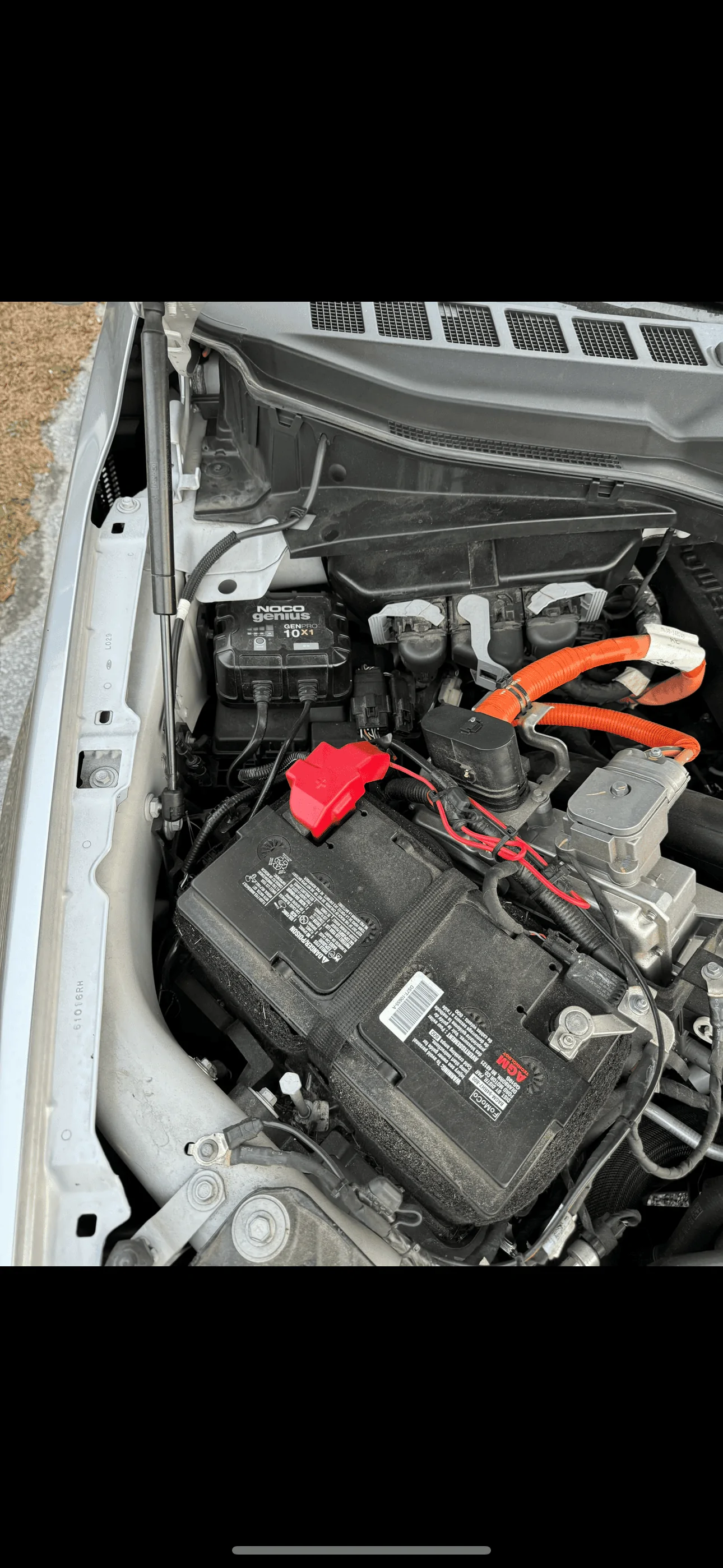

2022 F150
Ford F-150 How to install a permanent trickle charger on new F150 Lariat 2023. Also how can I have the Battery/Alternator level on the screen steering wheel? IMG_2037
120 plug in wheel well.
