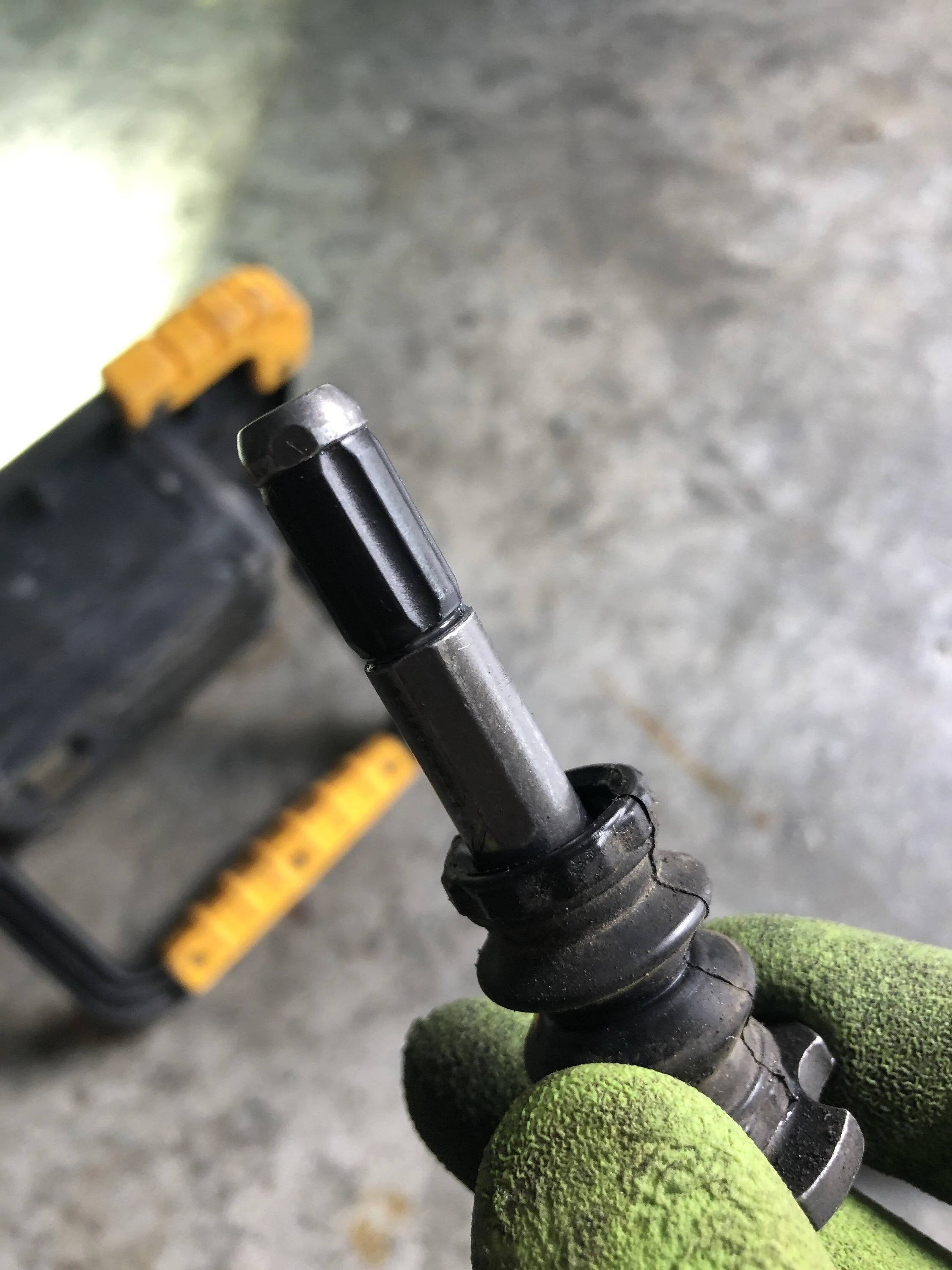

How often do you guys grease your caliper pins, boot seal, and where the brake pad ears sit
Ford F-150 How often do you grease your brakes D71896A1-0A56-4905-98AA-382FE1BA01A5
I typically use the high temperature brake grease once a year before the winter on all my old Ford vehicles and have never had to change a caliper (I kept most of them 7-8 years) not sure what the rule of thumb is for trucks

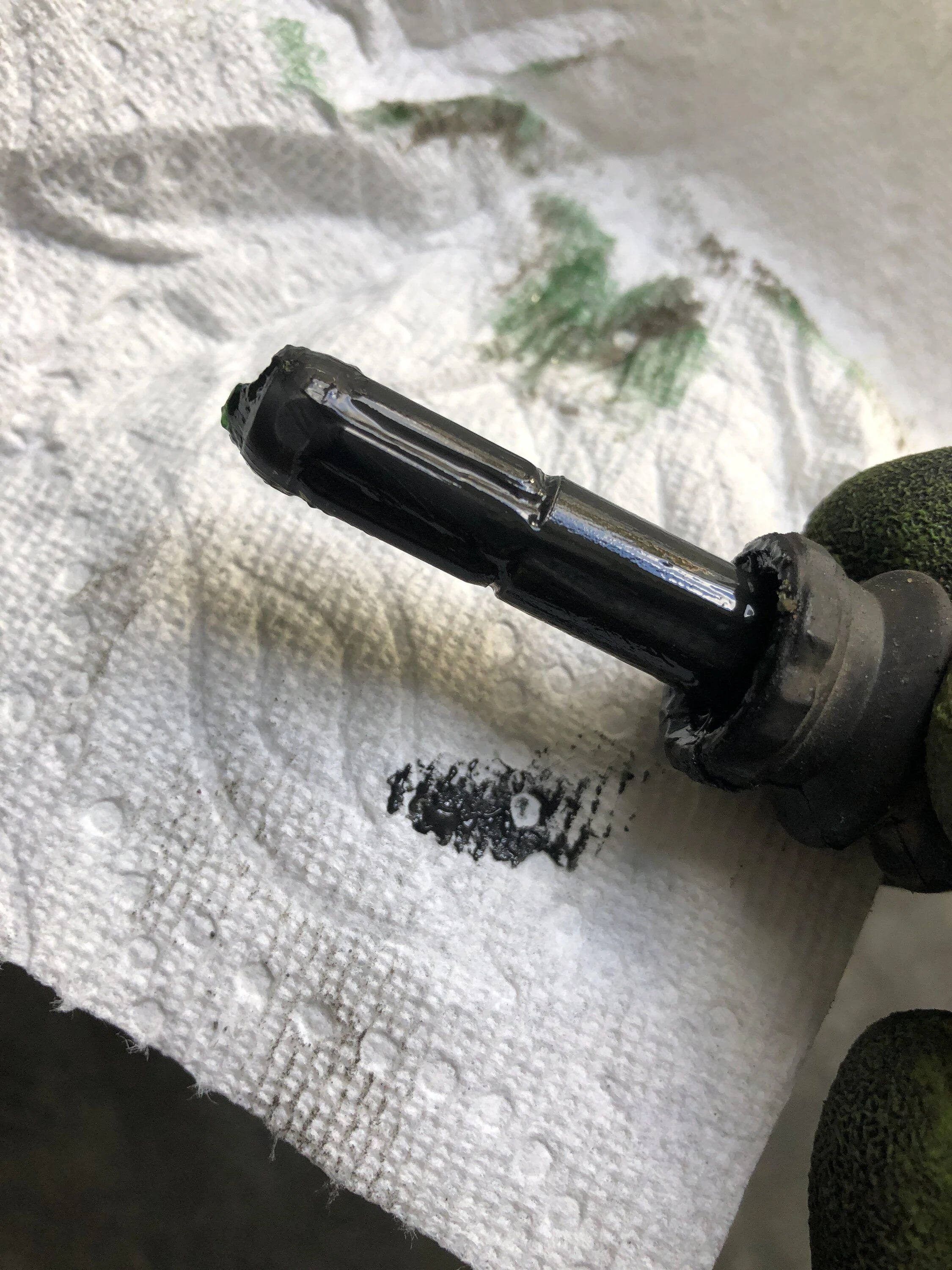

UPDATE:
pins needed a good cleaning and greasing, but turned out great about 15 mins per wheel
before:

After:
Ford F-150 How often do you grease your brakes F4DEBA2C-5A77-454E-8814-6E77A2AF7407
