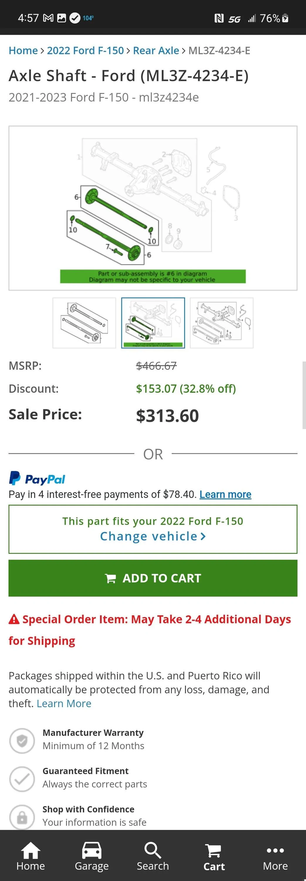

Other dealerships are able to make this repair with quick acquisition of the axle parts now. I wonder what the hold up is?
Even an online shopper is getting a warning of only 2-4 days wait on shipping
Ford F-150 How has the 9.75 axle not been recalled! Screenshot_20230908_165740_Brav
Ford F-150 How has the 9.75 axle not been recalled! Screenshot_20230908_165527_Brav

Wow, I wonder how accurate that is. If that's the case, then what the f"#@! They can't be that incompetent.
There are dealerships that have them in stock, according to some reports. The supply chain IS a fiasco when this first reared its ugly head, similar to the exhaust heat exchanger leak.
But eventually the supply chain adjusts for the dilemma. It sucks way worse for the first unfortunate fellas with the issues, but it shouldn't be nearly as bad for those two issues now.
