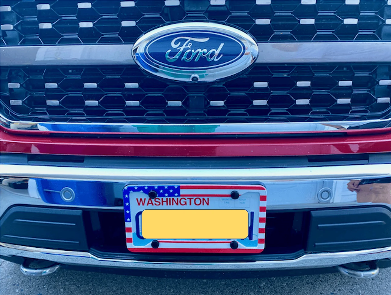

Here's what the front license plate bracket looks like for a 2021 F-150 King Ranch PowerBoost. It just snaps into place, and then you slide it UP into position. (Notice how the frame is cut out around the top, so it will slip up over the front bumper.)
Ford F-150 How about getting that front license plate bracket off? IMG_0867
I had to buy one because I bought the truck in Phoenix, but licensed it in Washington. The local parts man said, "that's never been a problem, because no one ever buys a truck in a different state." The bracket cost about $35. He had to know my VIN to specify the correct bracket. Apparently there are a lot of variations throughout the 2021 F-150 family.
Ford F-150 How about getting that front license plate bracket off? 1625535201129
