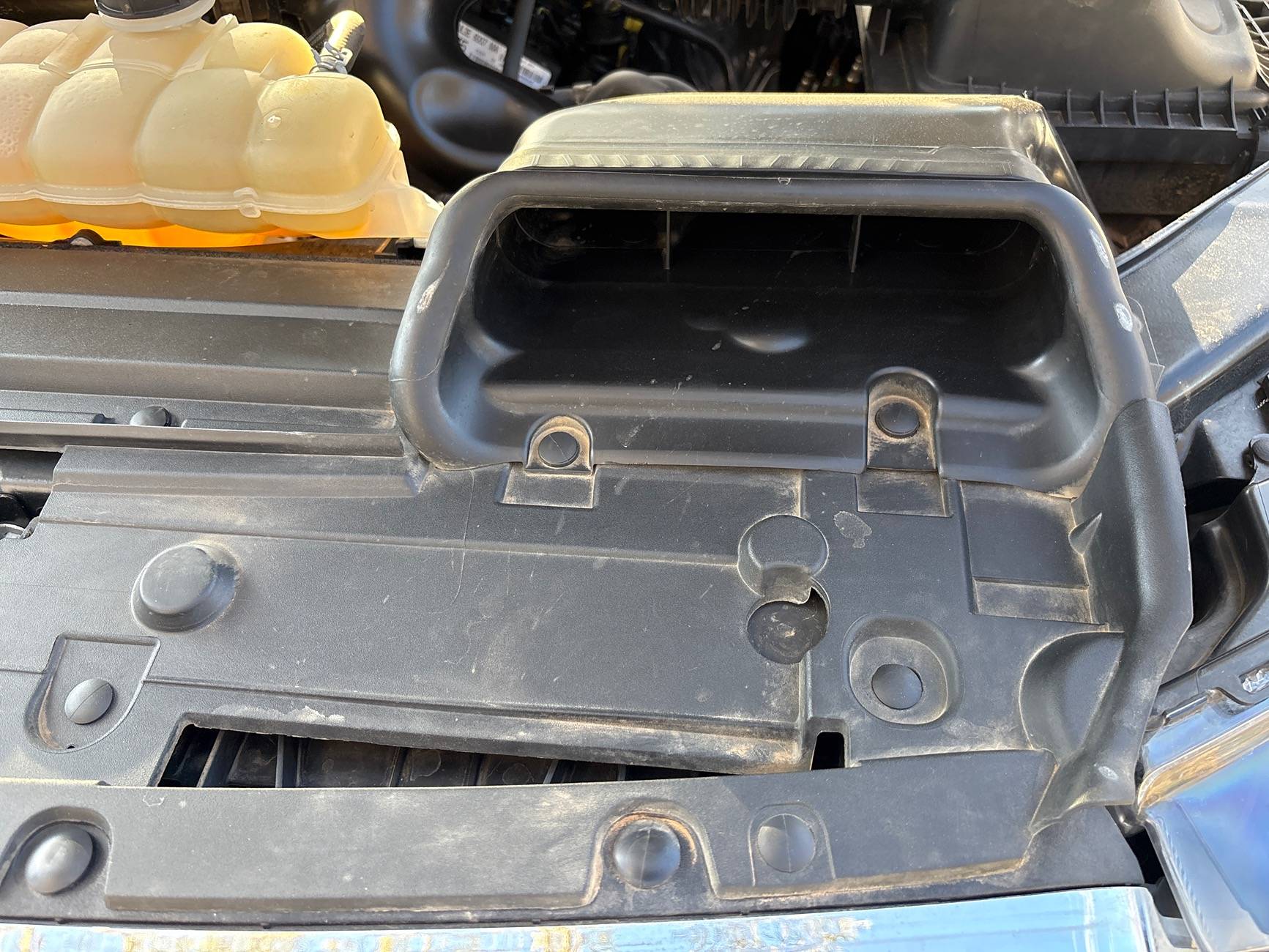

So this TSB turned into a recall for some trim models in 2024. I’ll try to find the thread, but there is a pretty evolved thread here about cutting this area out.
Essentially, what the issue is is this. That air deflector or what we used to call the upper cowl cover flexes. The turbos pull so much air it distorts and it moves upward toward the hood. This in turn closes off a good bit of air and the right side turbo gets starved air. This causes an over speed issue.
Many people who had issues with this talked of a smell a lot like what you’re talking about as well as a weird sound.
Thankyou very much. This also ties in the need for the Cobb bracket to reduce defection . Cutting out the section might be a better way for me as the shipping for the Cobb is 10x the cost of the bracket !
