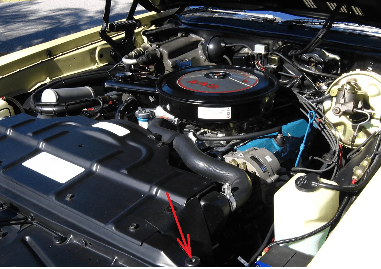

Not sure if this helps, but i used to have alot of issues with my hood bumpers (in red below), and as of a couple of years ago i really increased the tightness (unscrewing them), and have had no issues since. The edges of my hood used to flap in the wind.
Curious to see how ford resolves this in our current vehicles
