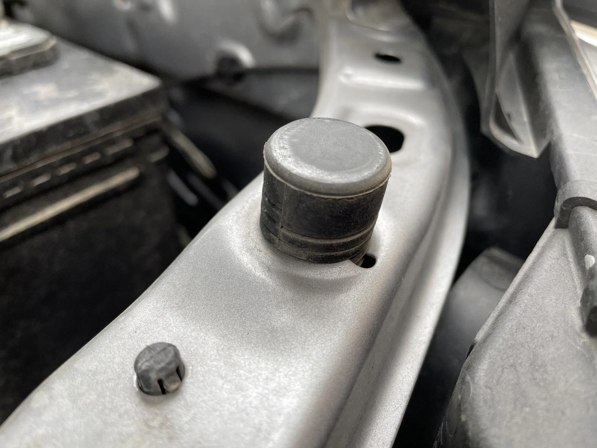

At each of the front two corners of the hood on the core support should be an adjustable rubber pad (seen below on my Toyota). Check to make sure those are adjusted correctly. This will take the slack out of the hood latch movement and should mitigate the flutter (in theory).
Ford F-150 Hood Flutter A3FC9F38-7DED-4F2D-8DEF-7CC552465A73
