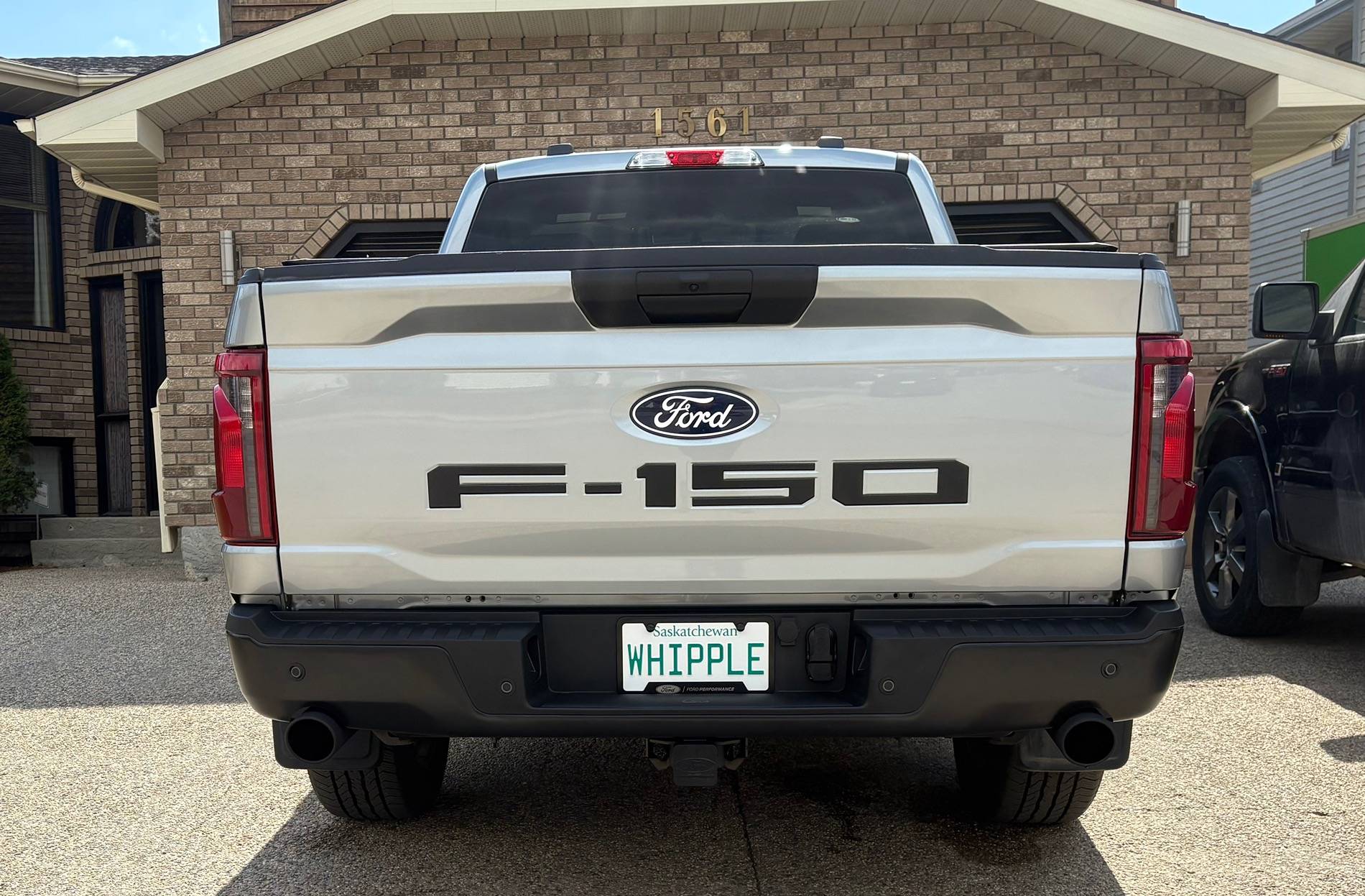

After finishing my duel rear exit exhaust I have turned my attention to fabricating rear traction bars.I never really liked the aftermarket options or there crazy prices.I have included some pictures.They work really well and I like the look as opposed to the ones that bolt on to the rear springs.

Nice job @Vauxhall Velox !!! Any more pics of the attachment locations with them installed ?? Any links to the hardware used ?

Nothing out of the ordinary,I have flexible bushings on the axle end and heim joints on the chassis, with opposite threads to enable easy adjustment.The bars are approximately four feet long.Cost was under $400 Canadian.

Any pic available from further back that shows the whole setup? ?
Nice job on the welding!
