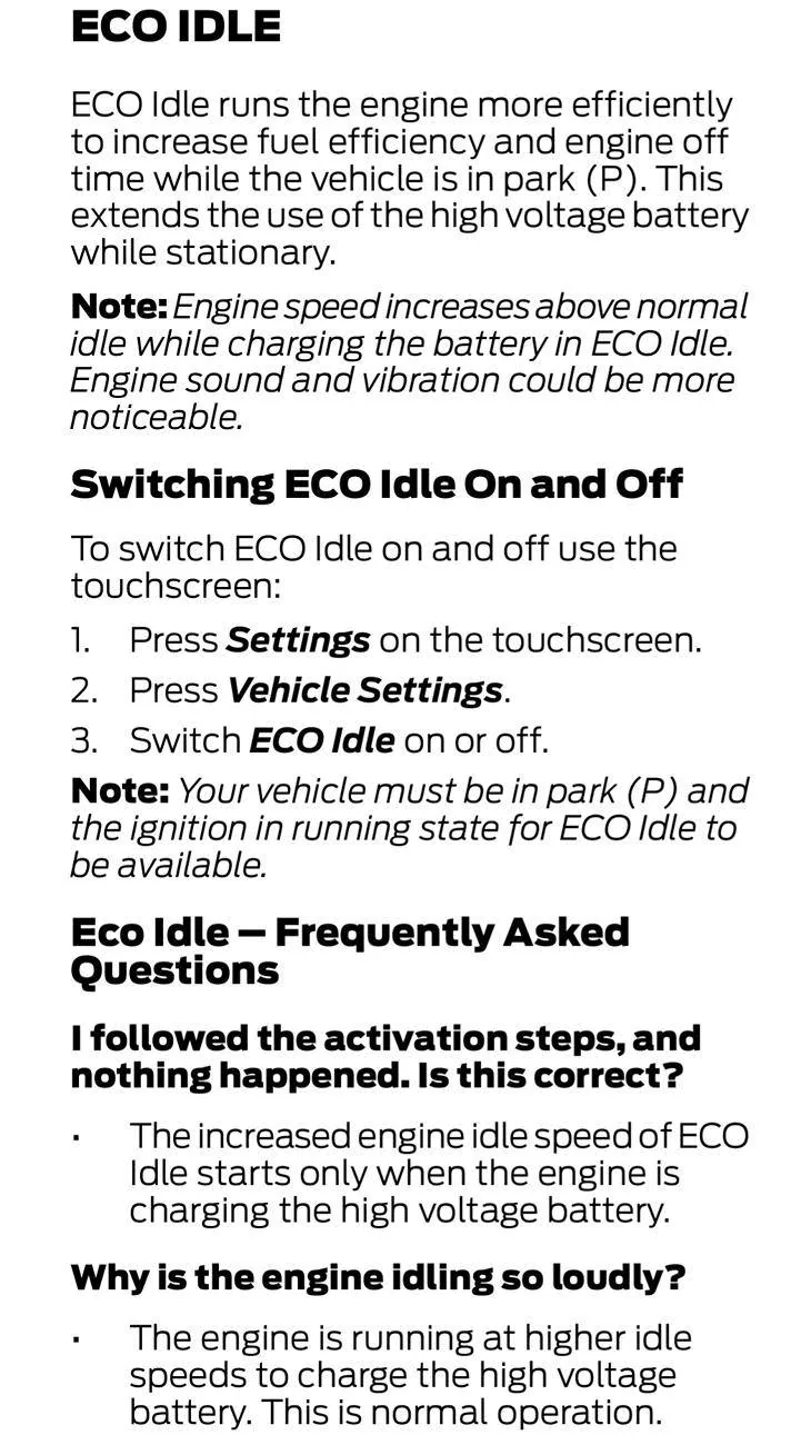

Perfectly normal behavior, especially on the Powerboost. It will ramp up the idle speed at startup to bring the cats up to temp faster. It also keeps the idle speed increased to dump more heat into the exhaust heat exchanger (unique to the PB) to bring the coolant temp up faster as well to reduce the time it takes for the engine to reach full operating temp. These are all for emissions. It may also keep the RPM elevated for an extended period charging the hybrid battery pack if it is at or below 40% SOC when at idle. During this time the engine will sound like it's under load then will shut off shortly after in most cases. You may also hear the turbo wastegate actuators cycling during the initial warm up period with a distinct chirping like or clanking sounds near the front fenders for 2-3 seconds.
After that when it starts the ICE back up and idles to 1500 rpm, it's due to ECO idle setting being enabled and recharging the hybrid pack back to 60% state of charge. Again perfectly normal for the Powerboost.
