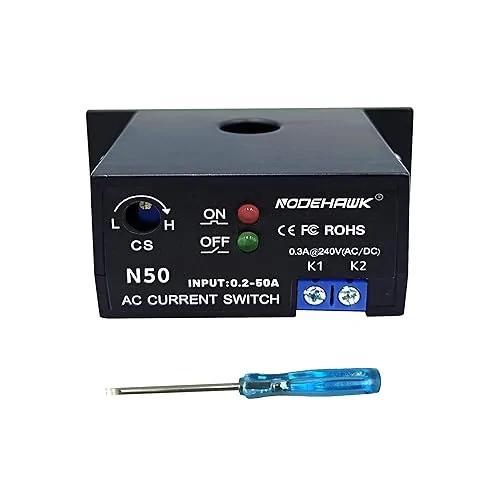

When it senses a current flow higher than the trigger setting, it closes a relay contact. This can be used to energize your off road lights.
Kanuck
Don
Aug 9, 2021
2,727
2,875
Winnipeg, Manitoba
Retired Electrician
Ford F-150 High Beam Trigger 71I6znfb9zL._UL500_
This one is for AC, but the DC ones are the same configuration. Headlight wire at or near the fuse block is run through the hole in the sensor. K1 & K2 are your relay contacts to supply power to your higher current relay. CS adjusts trip level.
