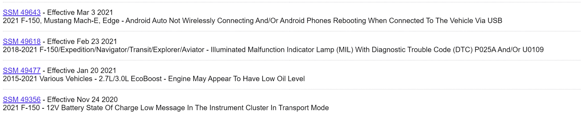

Thank you for the excellent reply. My issue was related to the alarm just randomly going off without a trailer. It called for a BCM update (SSM 49601) but Ford claims SSM 49601 does not exist.

I looked in Ford PTS and didn't see that SSM number either. If they updated those three modules you should have the lastest updates. Good Luck!
