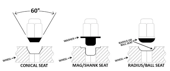

You can't just buy lug nuts for what the wheels came off of....
You need to know what your vehicle has for studs (M14 x 1.5 threads on 2021+ F150)
You need to know what the wheels your bolting on have for lug seat style.
You can get almost any combination of threads and seat styles.
