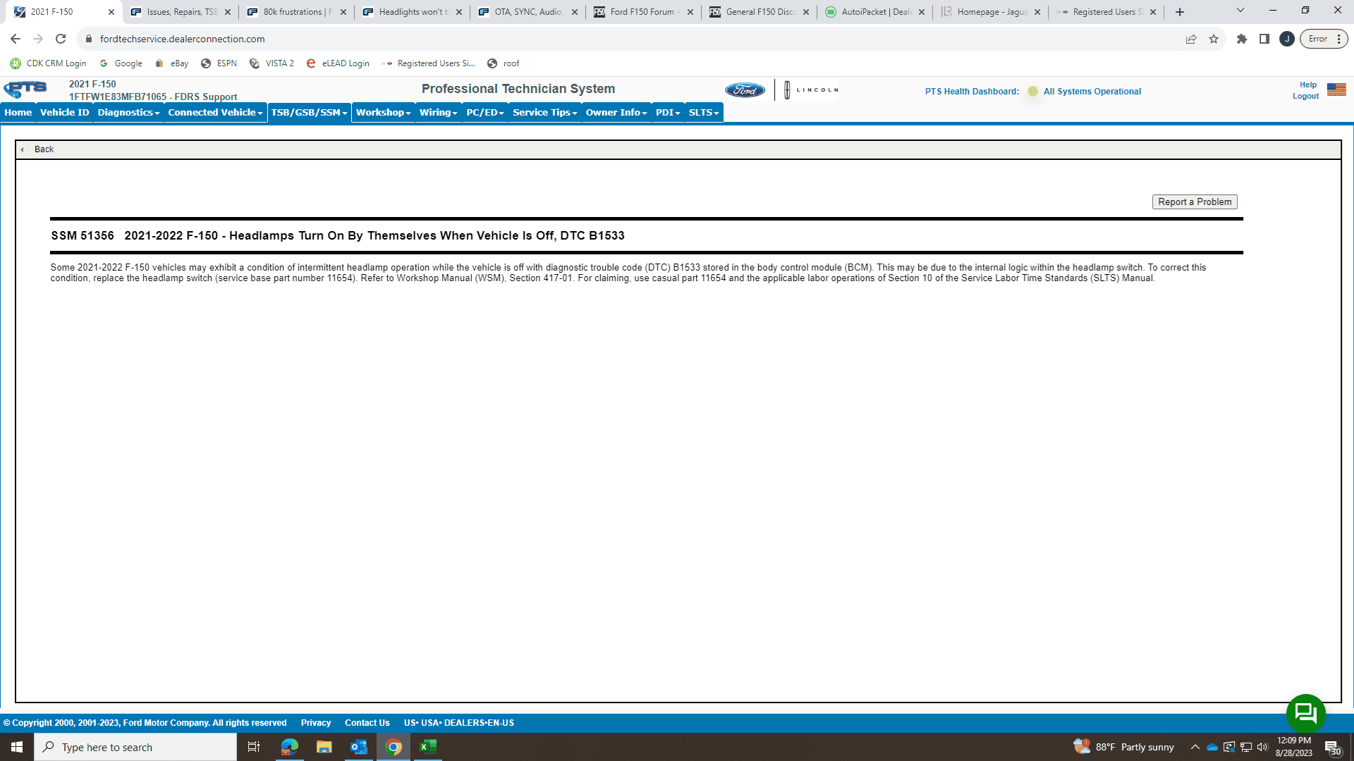

With your VIN, I can look up any error codes your truck is recording. I know there an SSM for faulty headlight switches. See attached screenshot.
