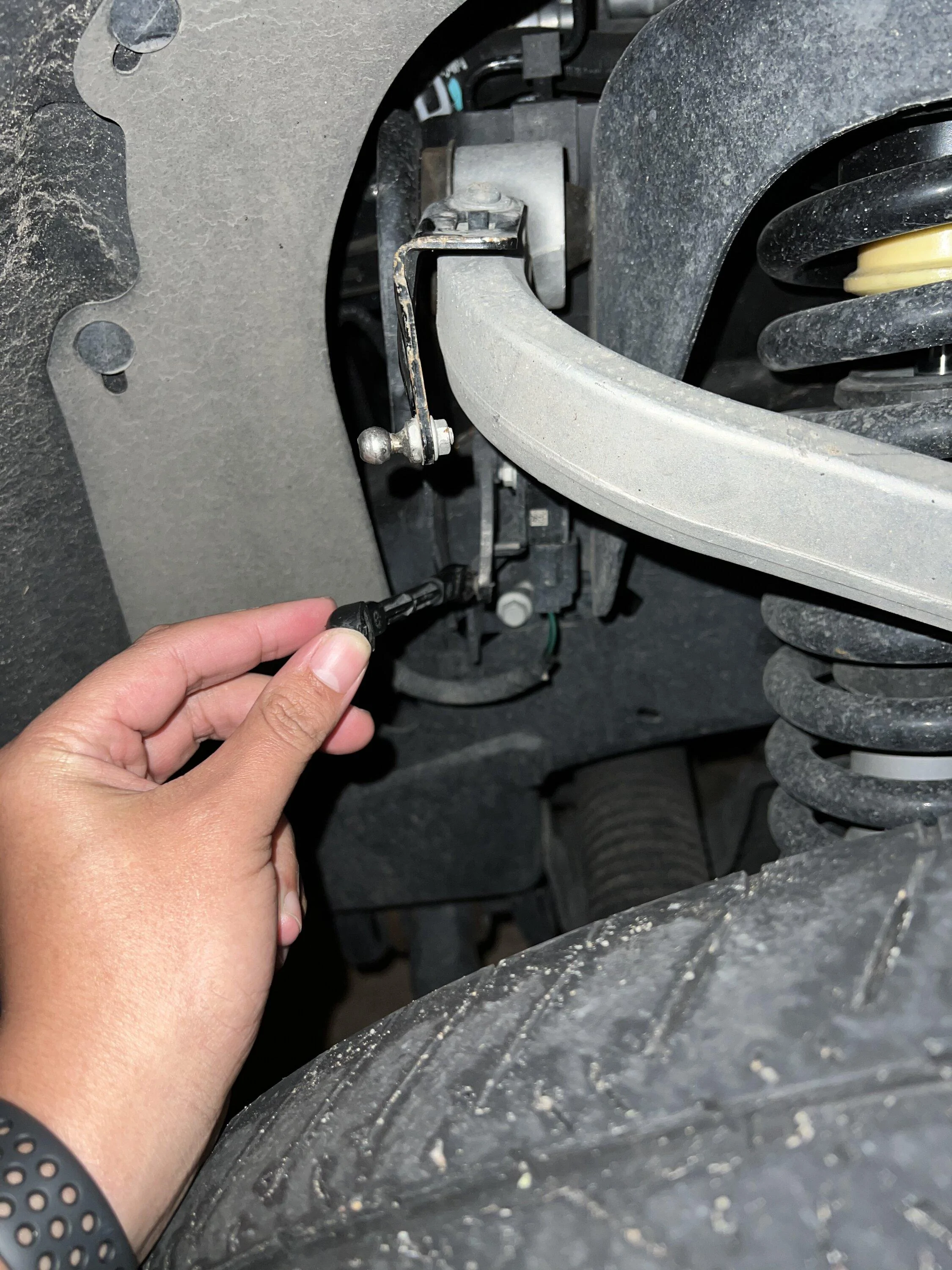

I have a 3 inch lift on my 21 lariat with projector headlights and this thing keeps popping off, causing my headlights to throw a code and be pointed at the sky help please

Looks like your thingie’s too short for the amount of lift you’ve achieved. How did you accomplish the lift and who did it?

yeah i agree as well and think the excessive lift height has compromised its integrity.

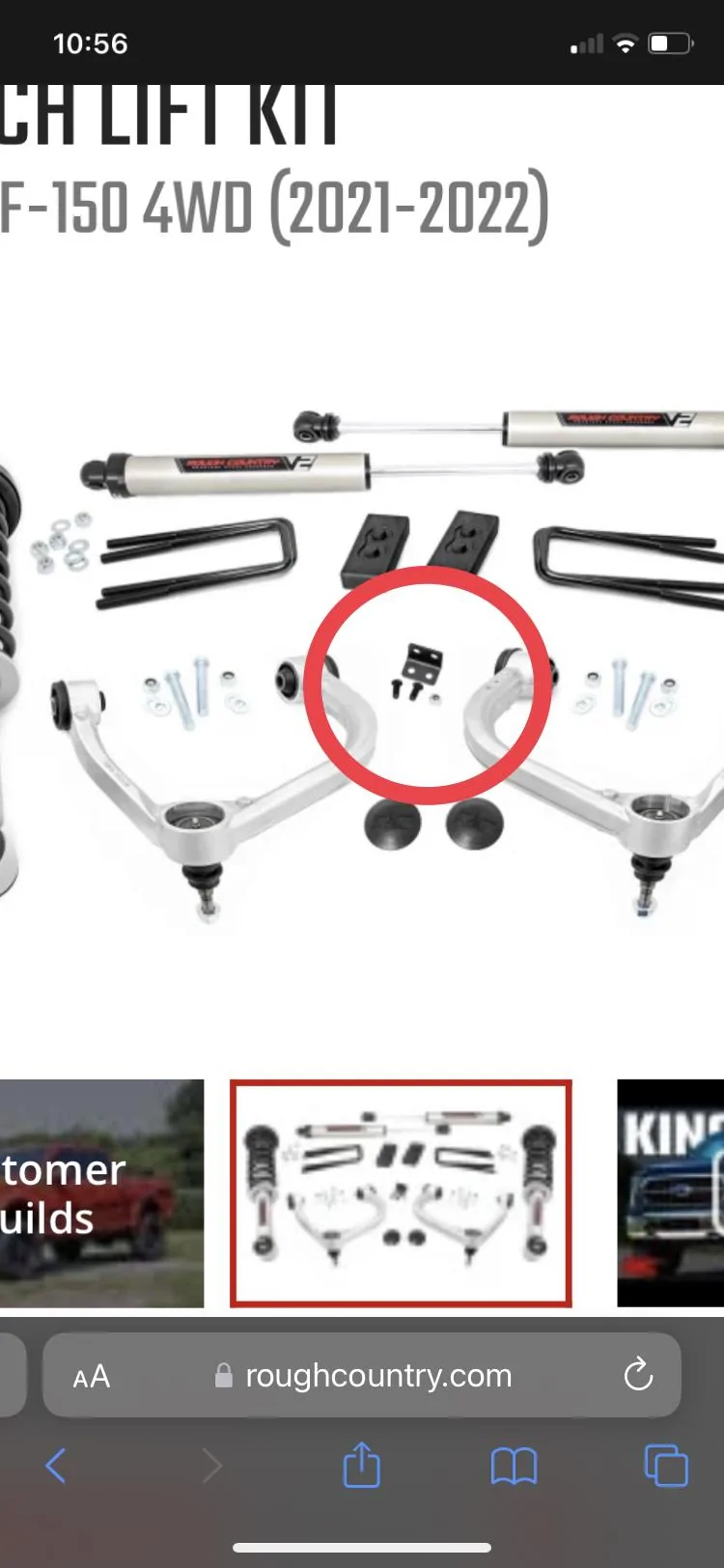

I did it it’s a rc 3inch they didn’t include any hardware to replace it fml

Looking at the kit, it indeed looks like they DO NOT include a longer bar so you aren’t just missing yours, although it does look like they include a bracket. Did you use their bracket, or the OEM one you pulled off your F-150?

From the factory, the attachment to the upper control arm is flipped (mounts under the upper control arm), is it possible to do that with these new control arms?

Huge Thanks to all of the bracket was in the u bolts box and it works once again thank you ??
