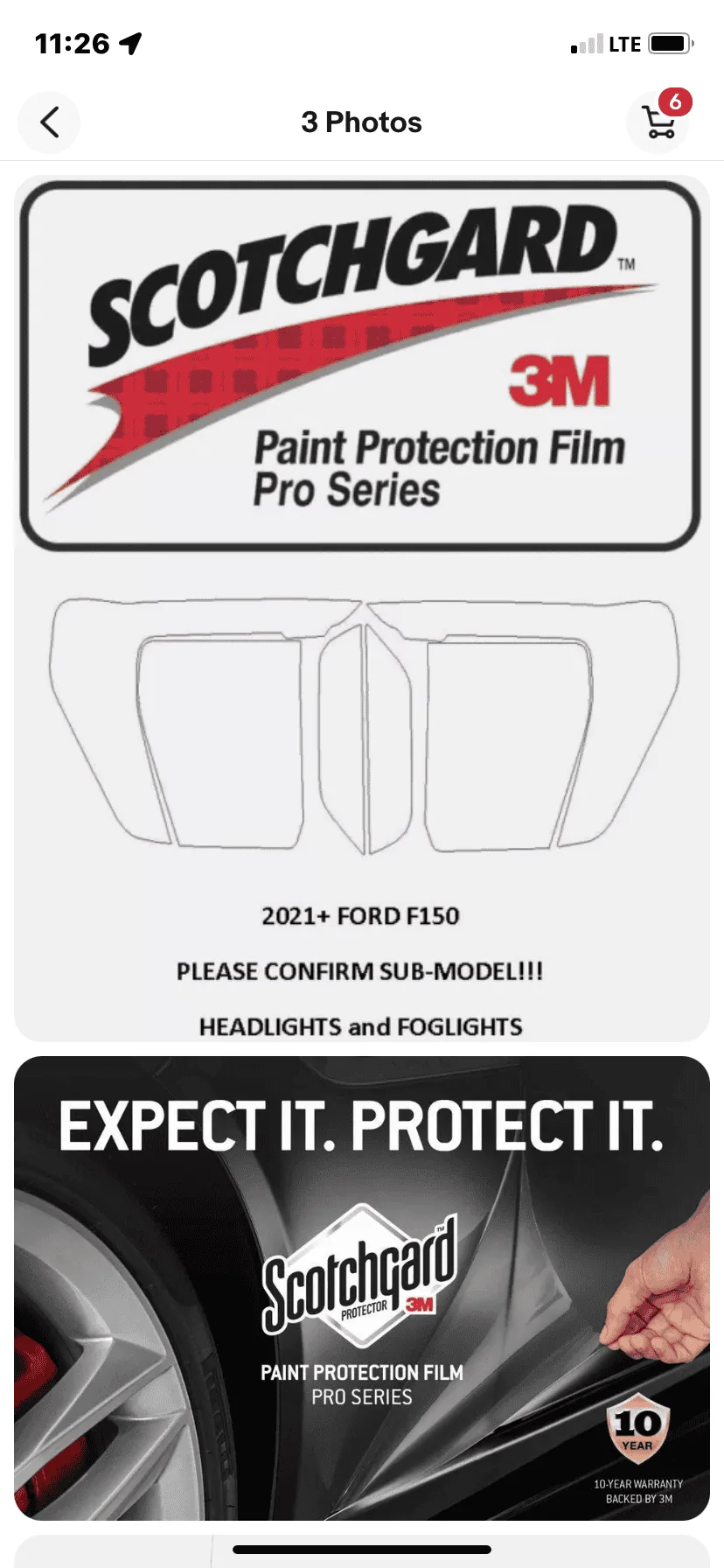

I bought 3M Pro. The pic below is not 100% accurate as the thin strip on the bottom doesn't exist in the 2021 but the thin strip on the top does and that's what made it harder. I should have tried a blow dryer to help but I got so many sections that were not laying flat that I decided to cut the thin strip off.
https://www.invisiblemask.com/imask/index.php?route=product/product&path=42986&product_id=190855
Ford F-150 Headlight PPF Saga Captur

I also purchased 3m pro and received this kit which matched up great yours almost looks like a 2020 kit
Ford F-150 Headlight PPF Saga 499F2989-1E5F-4C1D-A4F8-E1AFB2005E6B

Have you installed them yet? If so, how do you like it and how's the quality?
