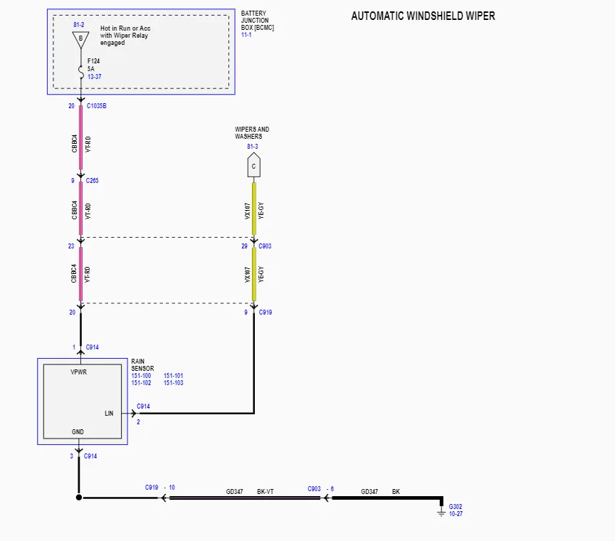

The rain sensor is simple.
The rain sensor has a lin bus that runs to the wiper motor. Thats it. there is no other interaction.
The sensor detects rain and tells the wiper arms to turn on.

Have copy. I wondered exactly how it was accomplishing the task assigned. Out of curiosity, would it not throw a DTC if the sensor had failed? This is my biggest hesitation with just ordering the part and slapping it in.
As far as flashing the SCCM without FDRS, how would this be accomplished?
Rain sensor is $30
I have the ability to flash it I would remote in
