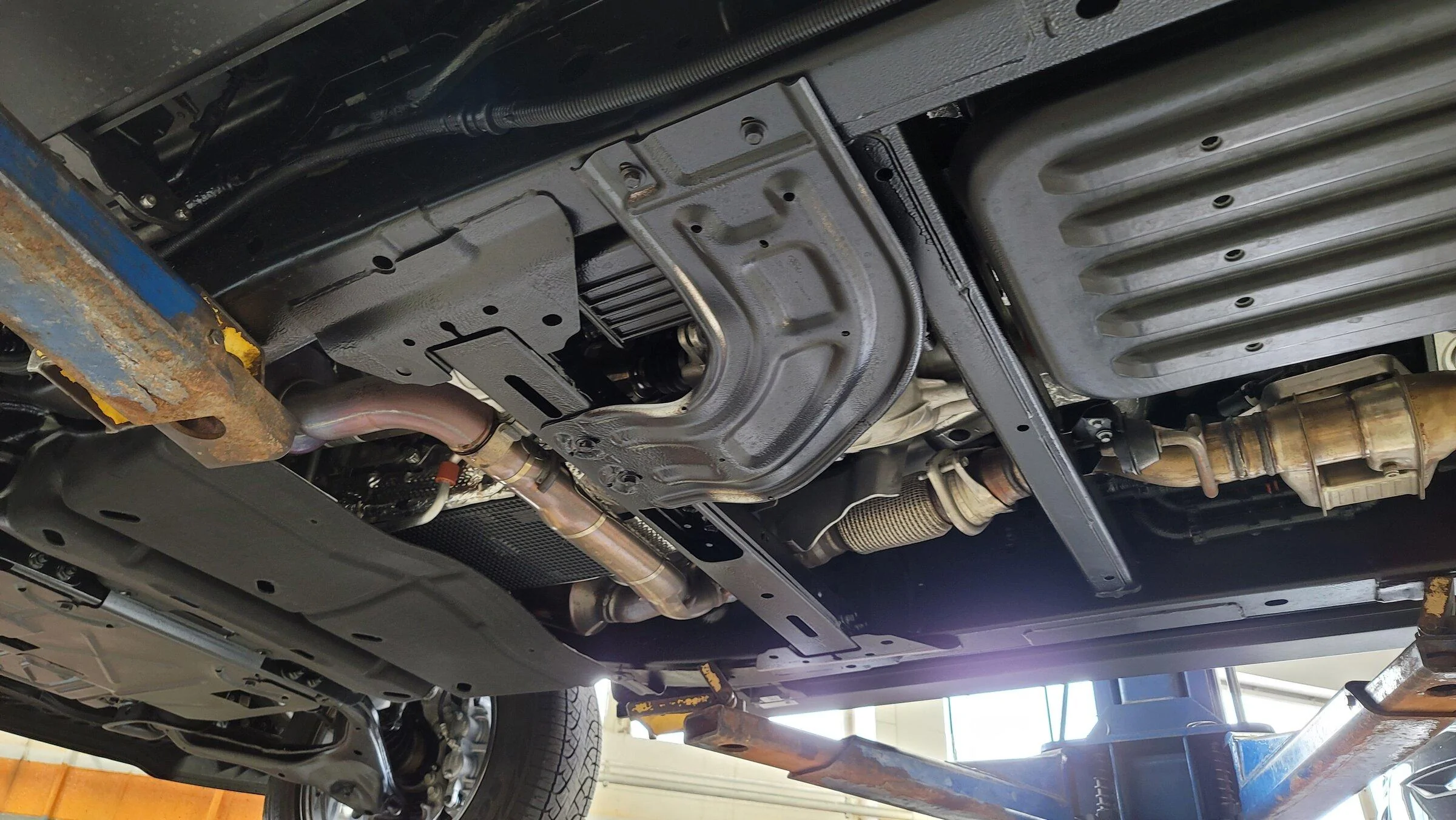

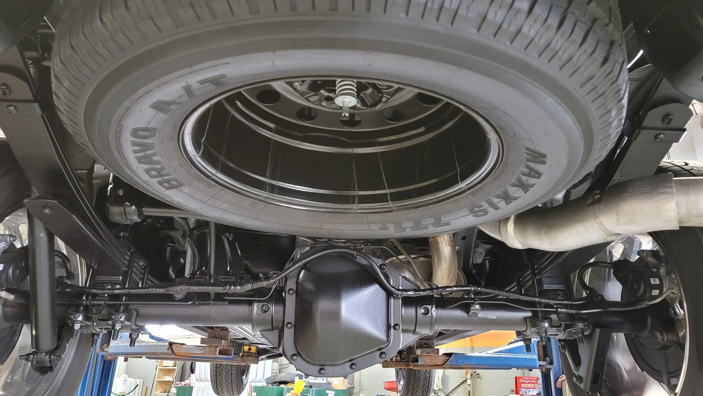

Make sure they tape off the back of the rims so you don't get overspray in them. Otherwise, Line-X should undercoat around everything.
Ford F-150 Getting undercoat done tomorrow. Any guidance? 2021 F150 Undercoating 6
Ford F-150 Getting undercoat done tomorrow. Any guidance? 2021 F150 Undercoating Back Wheel 2 - 21_05 29
Ford F-150 Getting undercoat done tomorrow. Any guidance? 2021 F150 Undercoating 1
Ford F-150 Getting undercoat done tomorrow. Any guidance? 2021 F150 Undercoating Differential 1 - 21_05 29

Yeah that’s real nice. Pictures make me even more glad I’m getting this done. Mines a 2022 and there is already rust on a few of the parts underneath. Thanks for the Picts also
