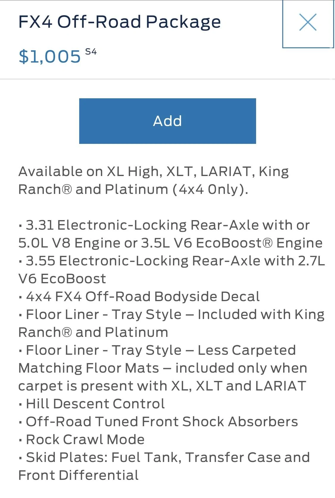

The FX4 package will give you the following per the build and price tool on Ford.com:
Ford F-150 FX4 vs Sport 4x4 DC5E9568-1A12-412B-837F-DBEDDDB699DC
It a a legitimate, entry level off-road package from Ford that gives you the skid plates, slightly different front shocks, and additional drive modes.
Whereas the “Sport 4x4” is just an appearance package. It is possible to have the Sport appearance package with the 4x4 drivetrain, and add the FX4 package on top of it.
In regards to your question on driving in 2H, yes the front wheels are disengaged and will not be doing anything but steering in that mode.

The sport is an appearance package. The FX4 has "offroad" tuned shocks, drive modes, skid plates, e-locker standard, basic a/t tires, different interior, and rubber floor mats. You can get the e-locker in a non FX4 now but it used to not be that way. The ride will probably be a bit softer on the non FX4 but can tell you I have an FX4 sport and it rides pretty darn good.
The front drive shaft won't be engaged during 2wd. Lariat and above have the 4 Auto option that engages the front shaft but distributes the power to the front only when slip is detected like an AWD.

I believe it's the same height. 2wd trucks are about 1 1/2 inches lower. The yet to be released Tremor will have Tremor shocks and a leveling kit which will add about 2" to the front end of them over the 4x4/FX4.
