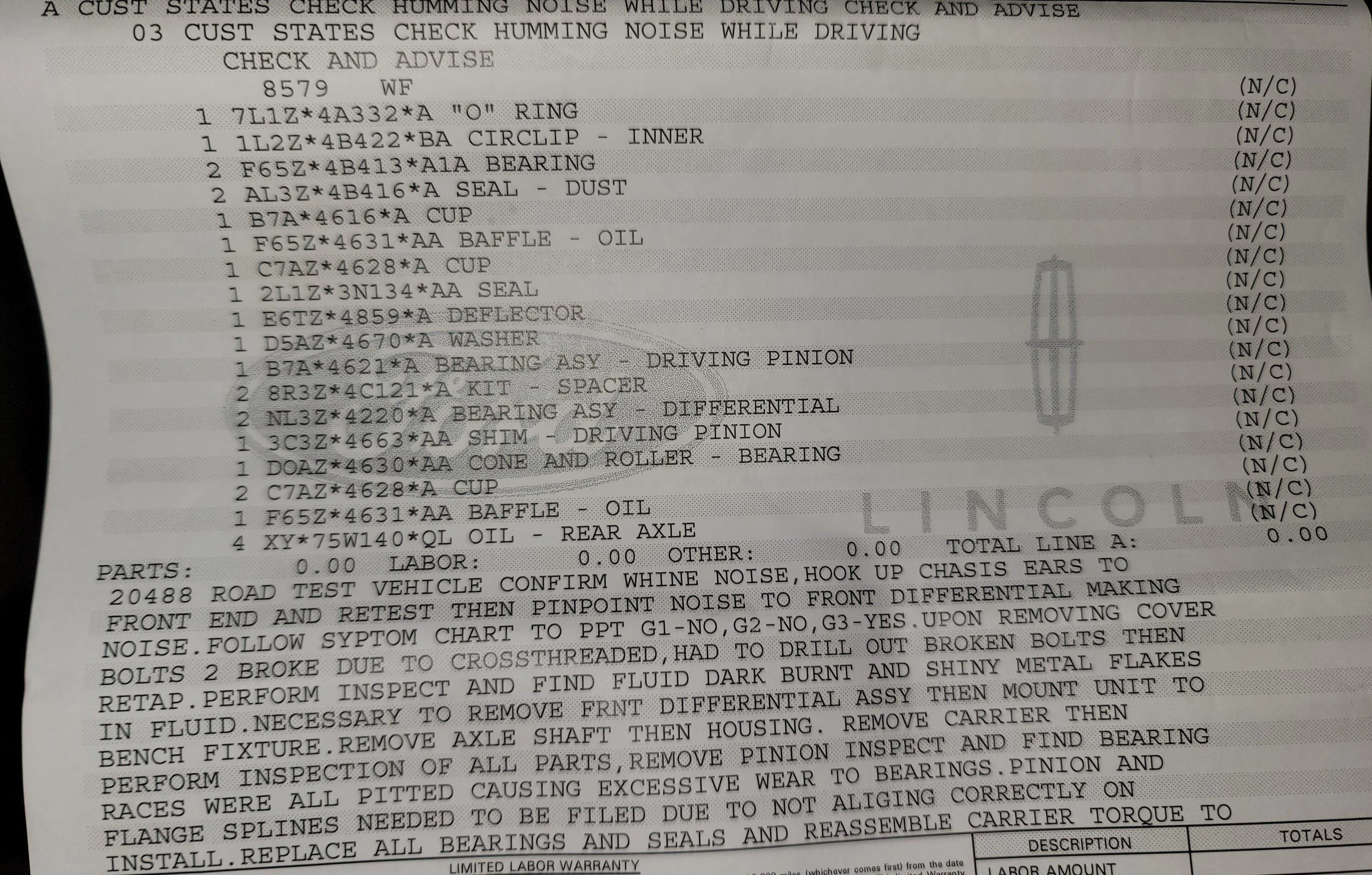

The Lincoln Navigator, Ford F150, Ford Expedition and Ford Raptor share the same front differential. At 20,000 miles I started hearing a humming noise which I thought was front wheel bearing or the tires. It was the front differential.
I have the Navigator.
The dealership took 1 month to fix it blaming it on parts issues. However I know they took a week to look at it and learned through Lincoln they had all the parts on August 6th. Had the dealership service department been on the ball this would have been a two week job at most. They turned it into a month.
Here is the writeup from the dealer...
Ford F-150 Front Diff Pinion Bearing Failure 20230822_141327

Seems it would have been easier to swap the differential. How did bolts get cross threaded was there prior work done?
