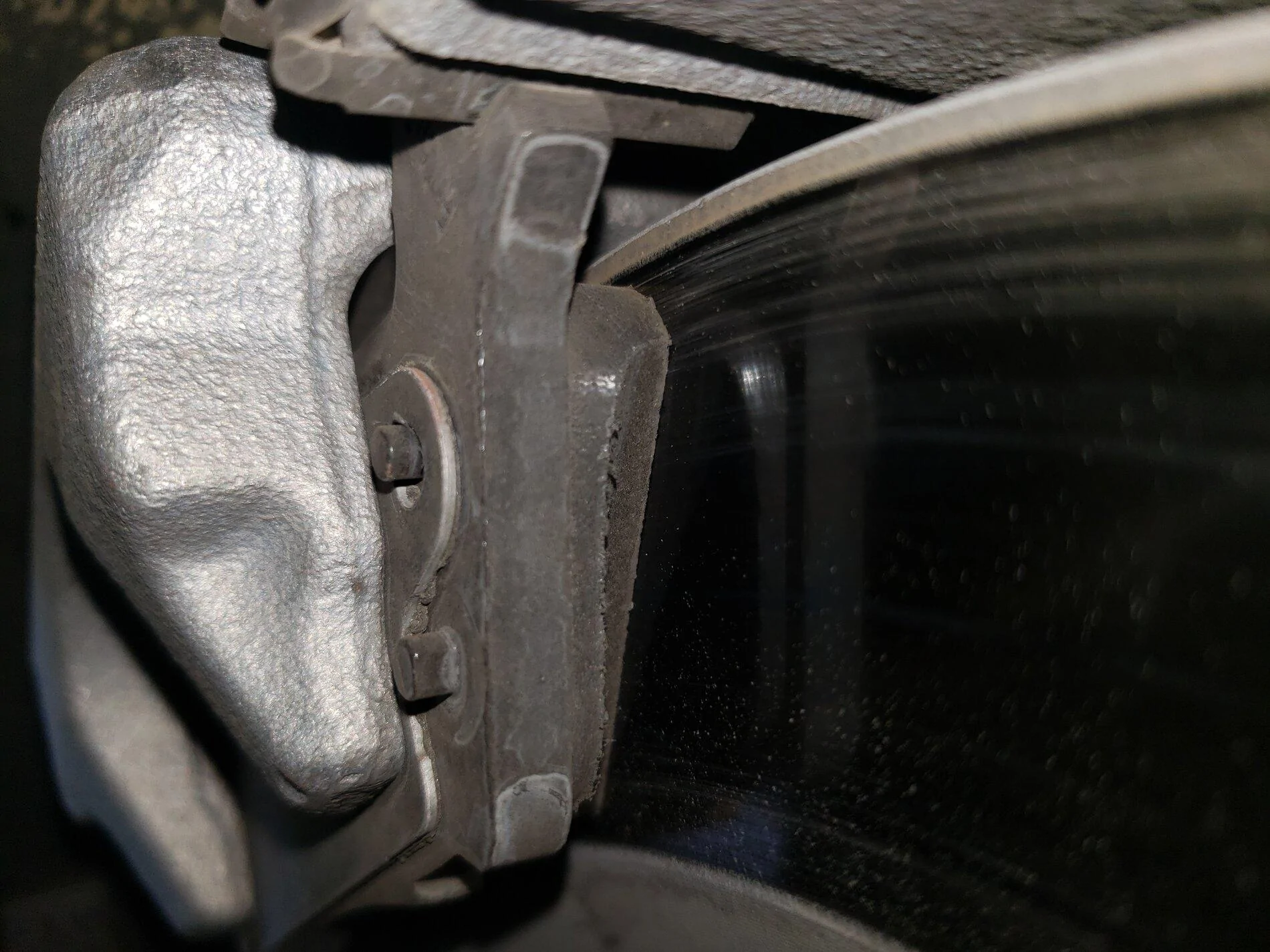

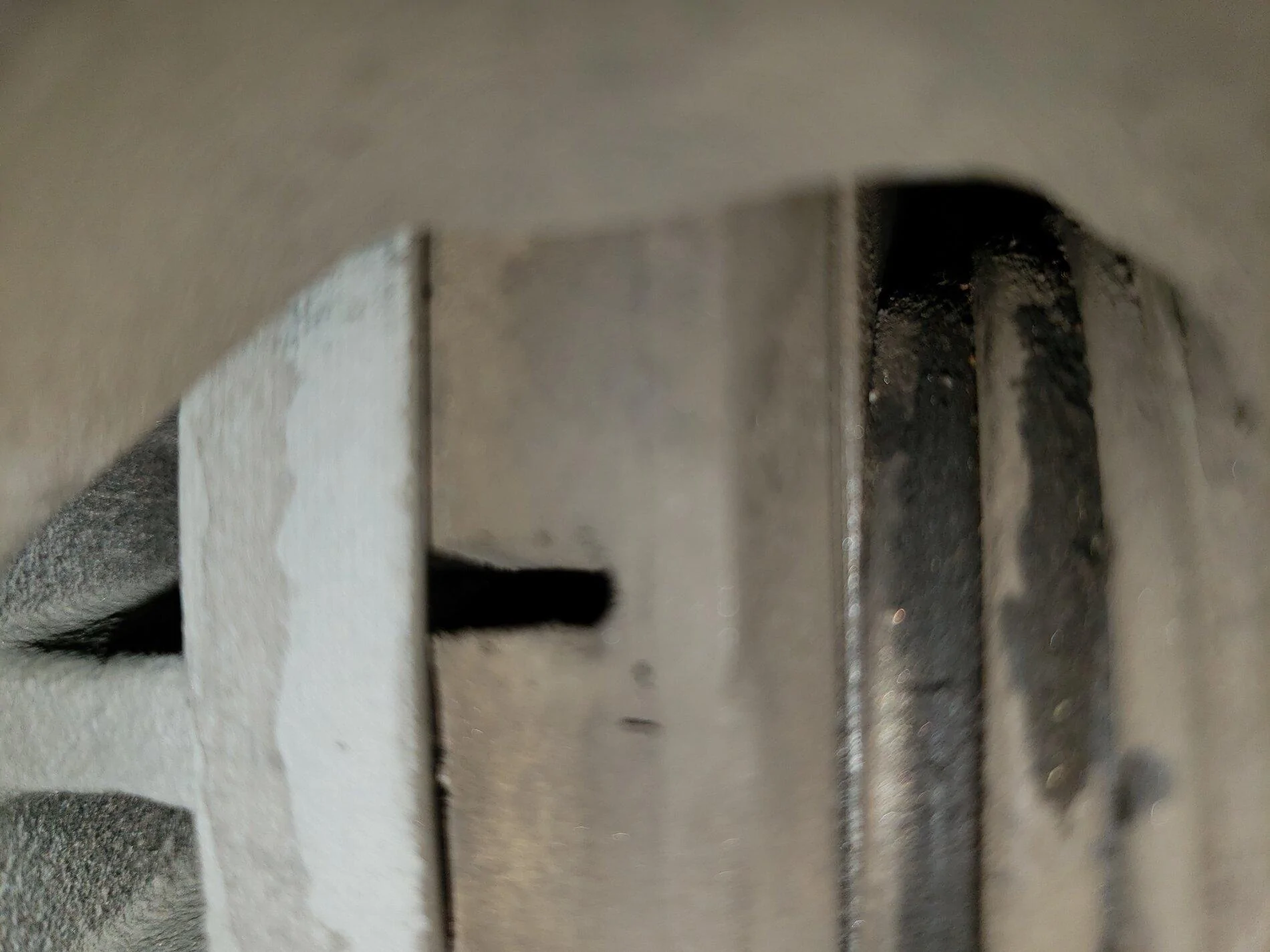

What's your drive train? I have 5.0. Is yours hybrid?
I think I can see outside pad through back of caliper on fronts, and see outside rears from side.
Stick your phone camera up in there with flash. Try n get all 8 pads.
I just did will try n upload some.
Sometimes inside or outside wear more. Left to right but you would feel a pull. Hot spots or warp and feel it chatter and always stop or lockup (ABS) at same spot.
I'm often threshold braking, at 3K miles and pads still look good and thick.
So worn out at 6k seems wrong.
Ive hot spotted, warped, cracked, gouged alot of rotors (and drums) in the past.
Run em down to the rivets, etc.
And over extended ruined caliper piston seals, bent parts, had angles on pad wear. etc.
Usually you can see discoloration, uneven radial rainbow chatter spots , or excessive uneven grooves in disc, hair line cracking at cooling vents, etc before they go way south.
OK got some pics last one is money shot from behind fronts looking back up with phone LOL
Common boys (and girls) show us your brake wear, power train and mileage.
That's 3k of hard ass braking. 3-4 times engaging collision avoidance system red screen of death! Just saying. LOL

YzermanTopShelf
YzermanTopShelf
Tom
Jan 19, 2021
220
218
California
2021 F-150 Lead Foot Lariat Powerboost
3.5EB (not hybrid). I have the max tow package (even though I haven't towed :LOL:).
I'll try to get some picture today. Thanks!
HA ha. I have hitch, Ford rubber plug, Reese tactical 2" hitch, anti rattle clamp and locking pin from Rhino USA, recovery shackle hitch, Master lock heavy duty stainless one piece barrel hitch pin.
And No I dont even own a trailer . ROFL (thats what happens on Amazon while waiting 3 month for truck to be built)
Yeh I'd like to see yours and someone elses so we can compare. Good info. Like make sure oil change was 7.x quarts not old Gen13 8.x quarts.

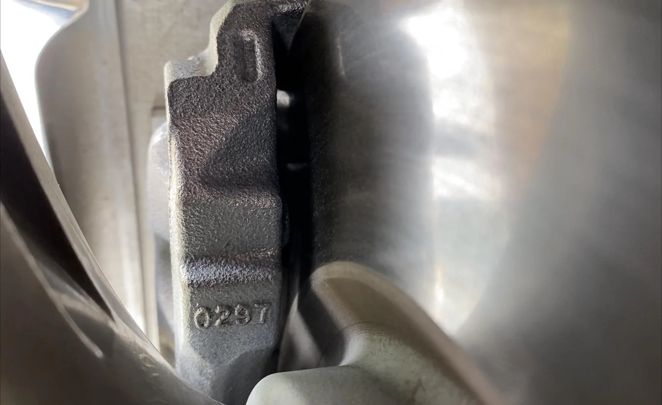

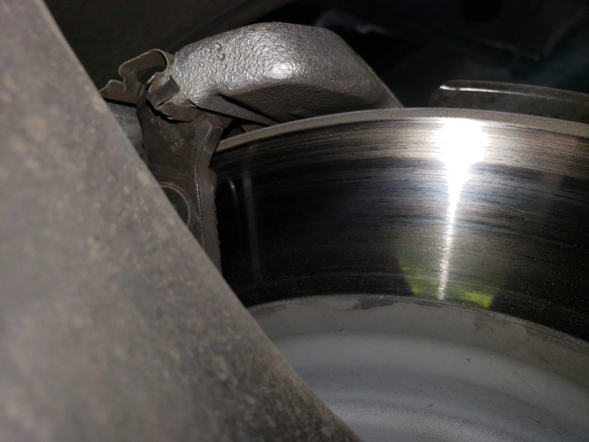

YzermanTopShelf
YzermanTopShelf
Tom
Jan 19, 2021
220
218
California
@KartRacer25 I took some photos but don’t think they are very helpful. At least I can’t tell anything for the break pad. Front left, front right and then a shot of the front right caliper
