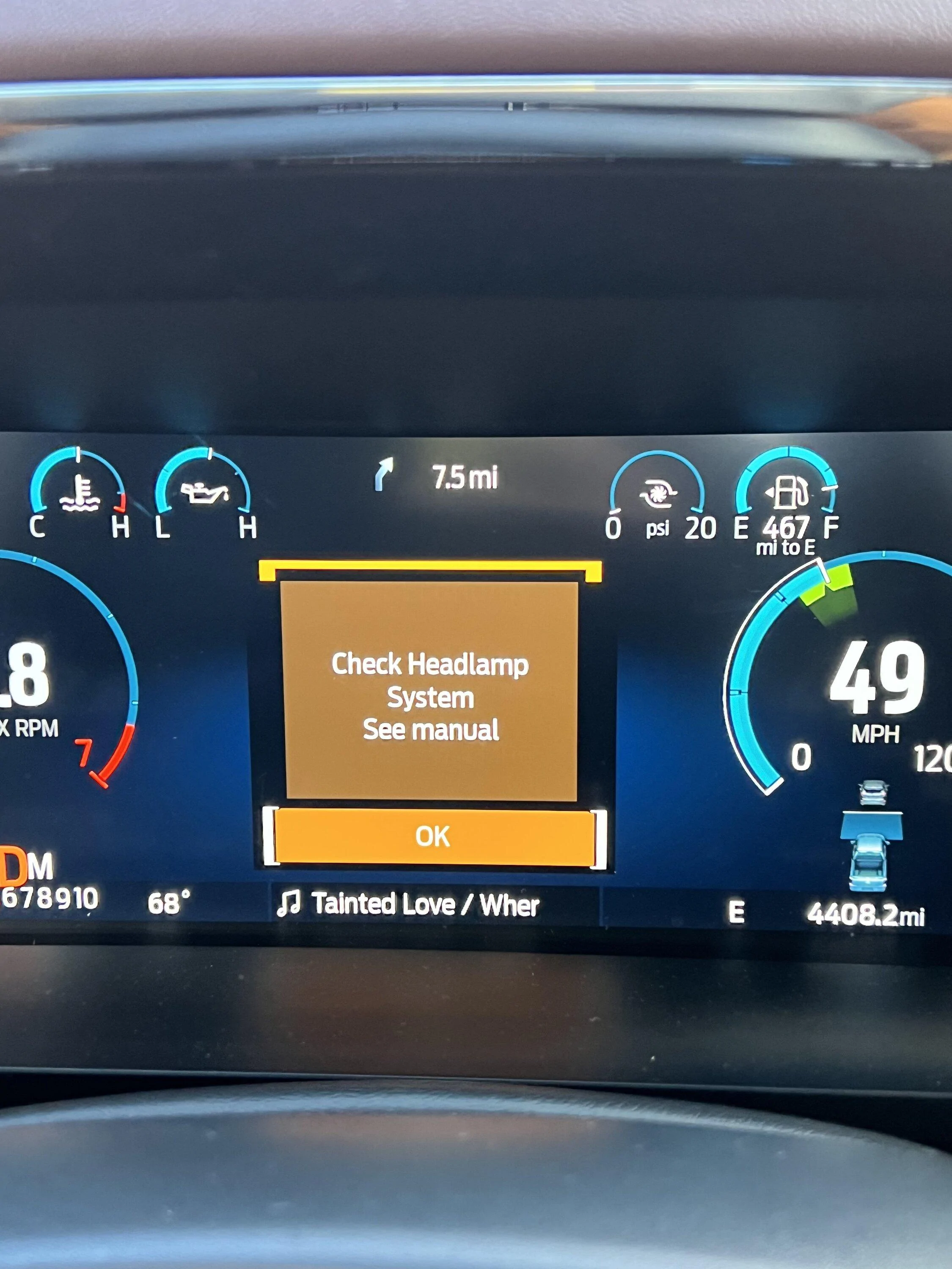

I just had the Fox 2.0 leveling kit installed on my ‘22 Lariat 502a. I’m getting a headlight malfunction error since i haven’t relocated the ride height sensor which apparently assists with headlight leveling.
is there a kit or DIY to relocate this to the proper position - after a level?

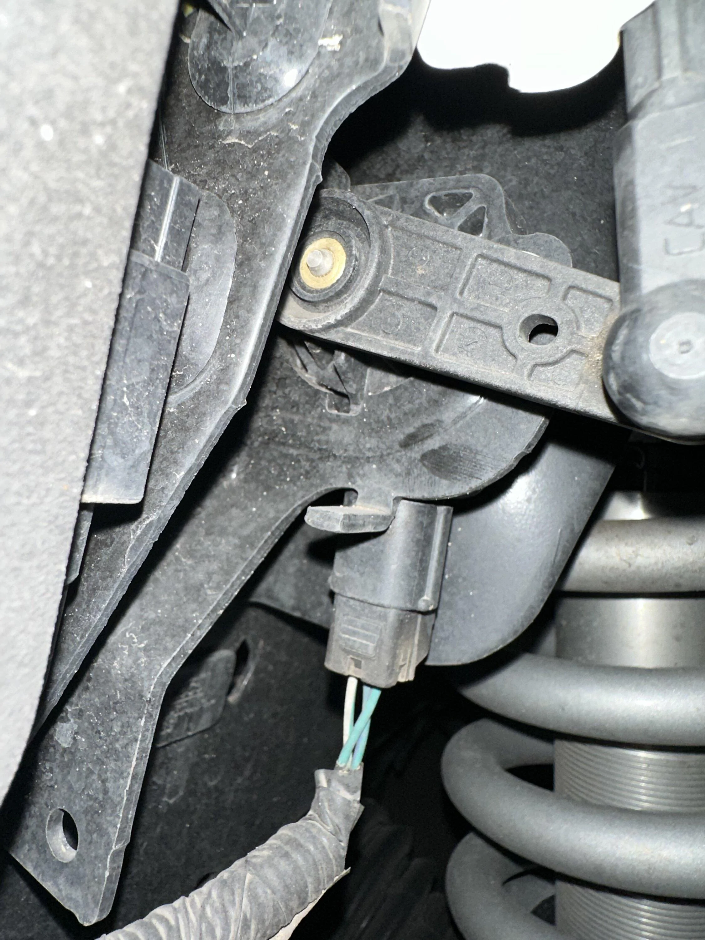

Can you provide a pic of your current setup?

yes that looks like the sensor I’m referring to. Is your truck a Lariat with 502a or Platinum? I was told by the dealer that those specific trucks required the adjustment after level.
Here’s the error I’m getting while driving
Here’s what it looks like on the driver side right now

I have a 502a lariat and I didn't get an adjustment or calibration afterwards.
** It does look like yours has pushed the rod all the way down, but could just be picture angle. **

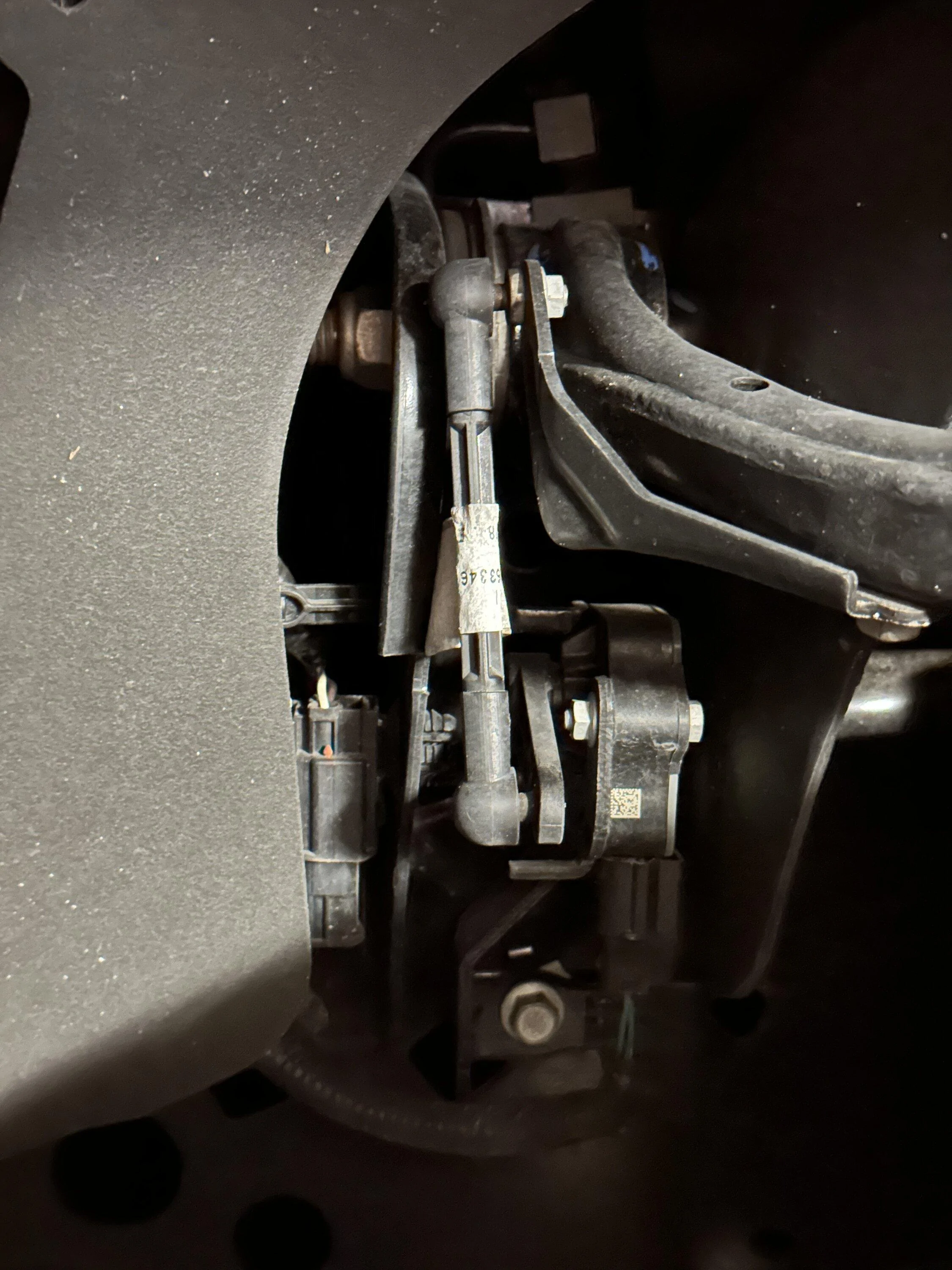

Azben
Feb 15, 2022
Az
2012, 2022:f150
It is hard to tell position from the photos as Chris stated so I tried to show the position looking at it from the front. I have the same kit on Platinum no ccd.

For anyone that comes across this in the future… the dealer fixed the issue today by moving the ride height sensor down a notch…i had no idea it could be adjusted, but apparently it can be. Problem resolved
