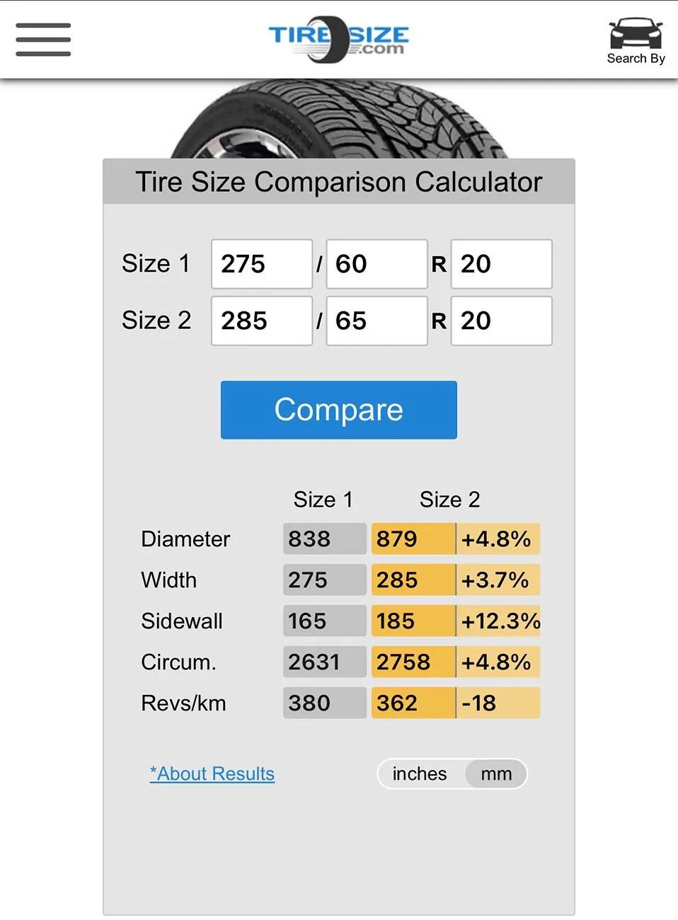

Go into the body control module (i think) and type in tire and you can change the size by millimeters. In your case your going from 2631 to 2758 mm.
