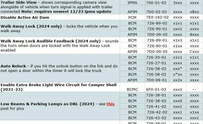

In reading another post recently I found what looked like a Forscan setting for enabling the brake light wire which I located under the hood a while back but never was able to get it to work. I have a 2022 PB. When I look in Forscan, I only see an asbuilt option for the BCMC module, I don't see the one which would help with the individual settings like a lot of the other modules have. Also, the addresses shown on my vehicle don't match what is in the table below. I'm interested in the Enable Extra Brake light option below. When I look at the BCMC in Forscan I only see about a half screen of lines and they all start with 7xxx so I don't see anything matching 6F0-01-03 as below. I just updated all of my modules about 2 months ago when I updated to BlueCruise 1.4. Thanks!!

Sounds like you are looking at the wrong module in forscan.
This one is easy to change as there are no other features that would be effected. Its either (0=off or 1=On) at the bit 6F0-01-03 xxx1-** @rockfish
