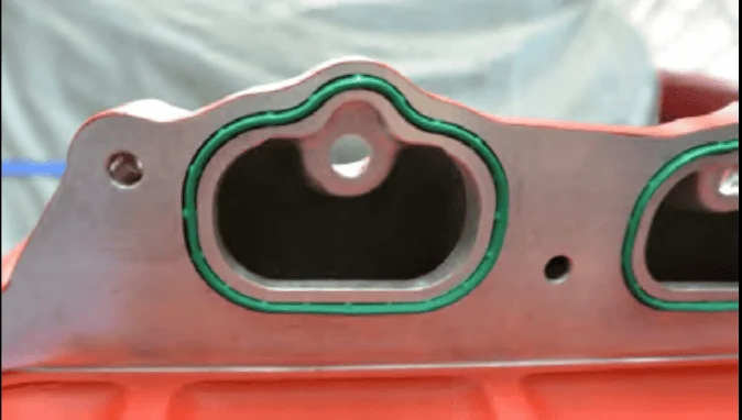

NVM, they are the PI or the port injectors. Kind of a dumb question after looking at the instructions again....
Ford F-150 Ford Performance Whipple? 1695152300589
Underside of the manifold showing a hole where the injector sprays...
Ford F-150 Ford Performance Whipple? 1695152368720
