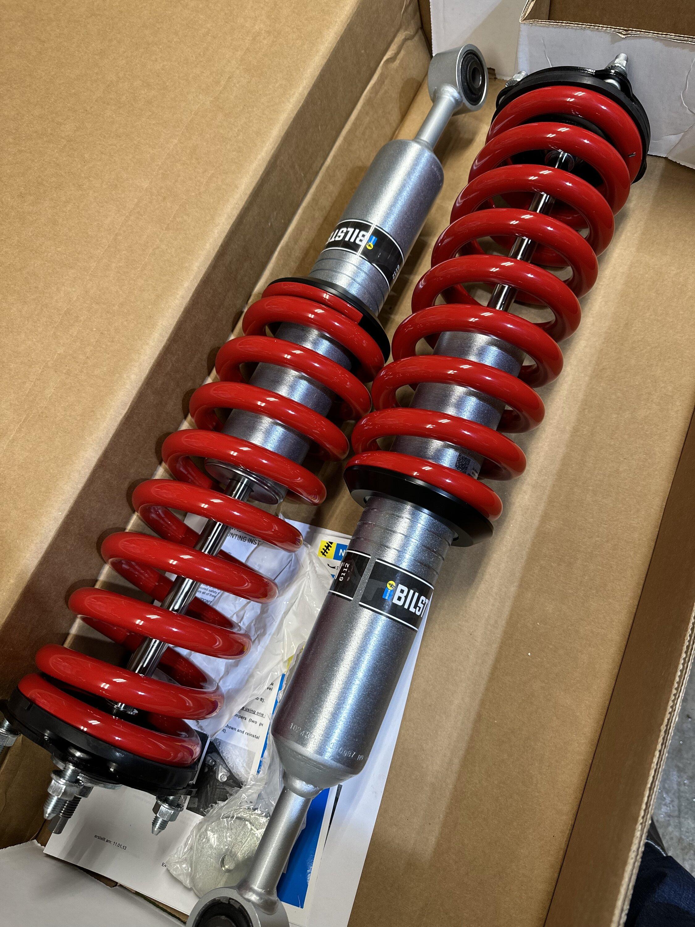

The 6112/5160 is for sure our top selling kit. We also offer full assembly for you with new top hats and hardware so that way you dont have to deal with getting all of that done.
That kit and the Eibach 2R which we JUST got back in stock the other day. Here is a photo to check out the color matched springs if that is something that peaks your interest!
