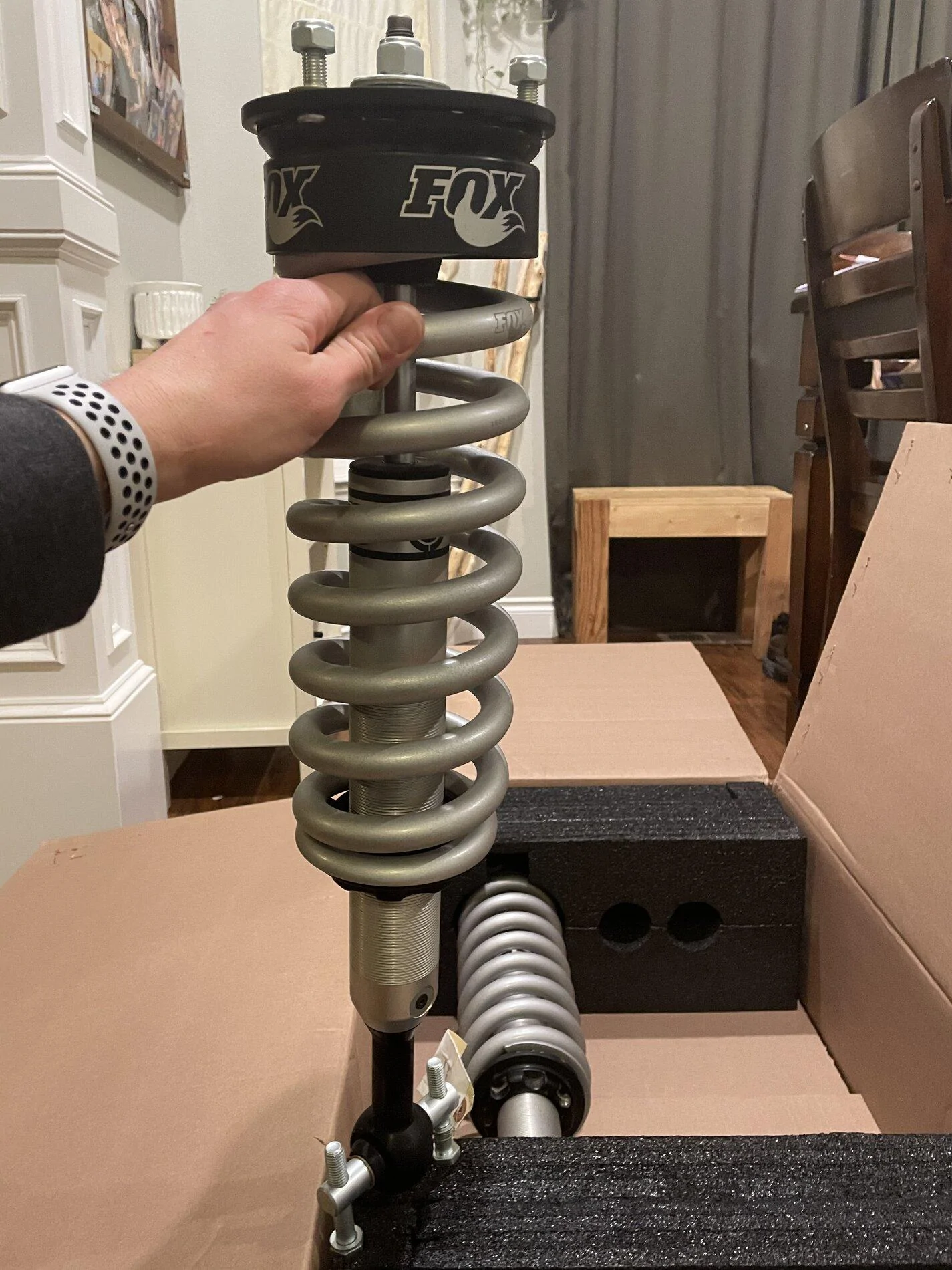

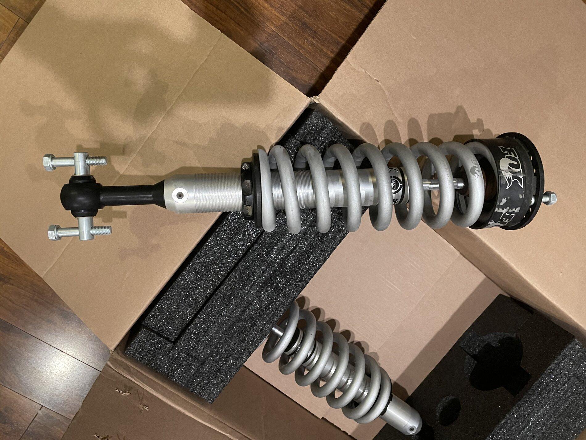

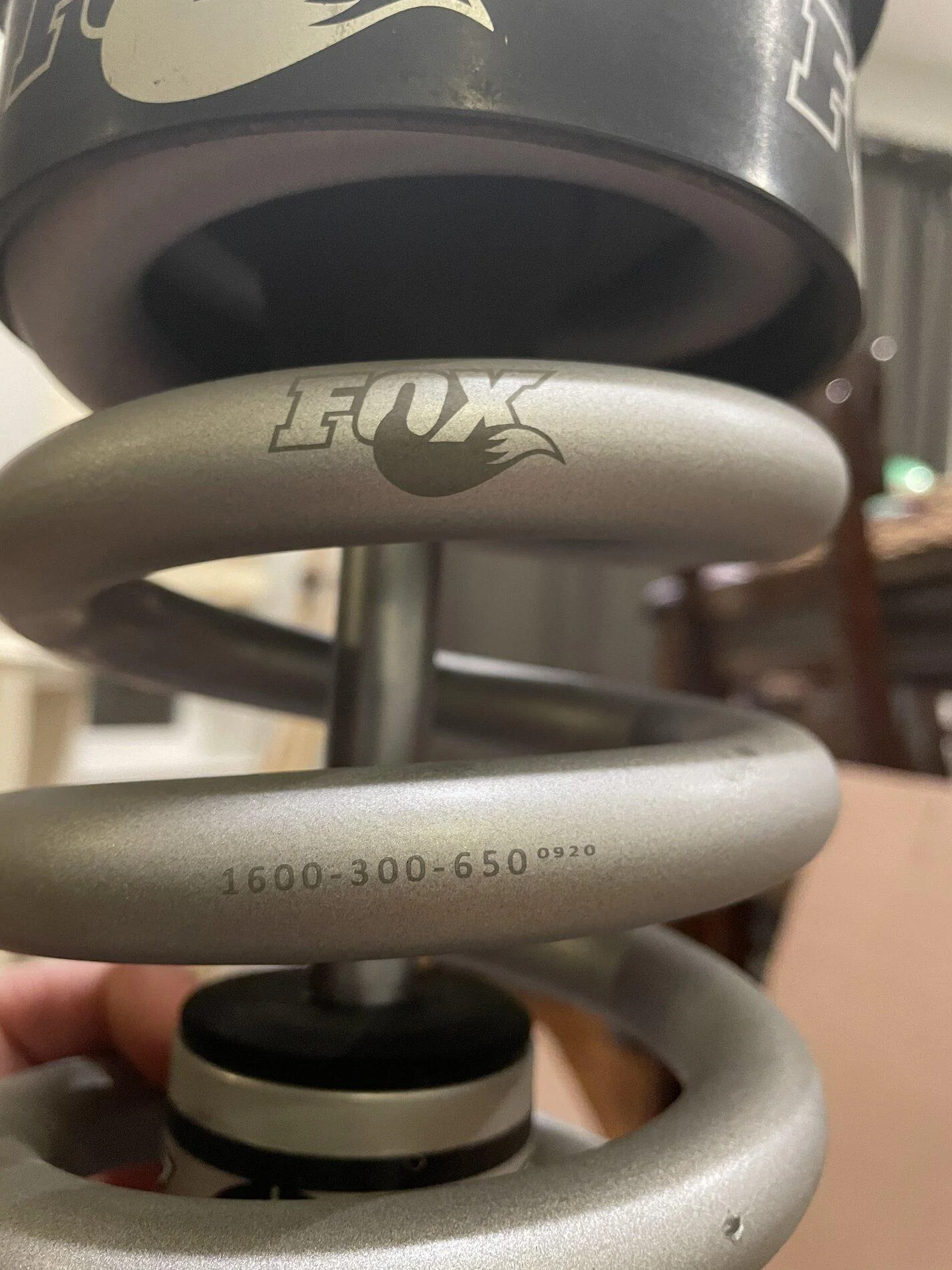

I have a set of Fox 2.0 coilovers that are set to the max height for level by Fox after the complete rebuild the Fox Factory in El Cajon did this winter for me.
Sitting all pretty in the box still and my wife doesn’t want me to put them on her Powerboost.
So, I’ll be unfortunately getting rid of them so that someone can enjoy them instead of them sitting in my garage.

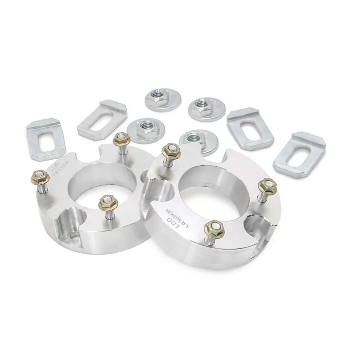

Can anyone offer any input as to the advantage/disadvantage between going with the simple, inexpensive "block" leveling as opposed to replacing the entire shock?
I'm going to be using my truck regularly on steep, twisty mountain roads and maintaining as low of a center of gravity as possible is very important to my chances of NOT rolling my truck down the side of a mountain.
I don't want a "lift". I can negotiate the ruts just fine without the added ground clearance of a "Lift Kit".
And the factory "ride" on the highway is just fine for my needs. I just want to get rid of the rake.
