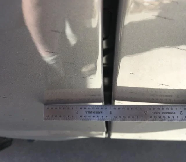

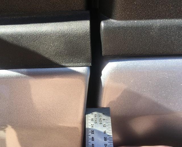

I picked up a '21 STX CCLB today and all 4 doors needed adjustment. The drivers was out about 3/8". Build date was in Feb.

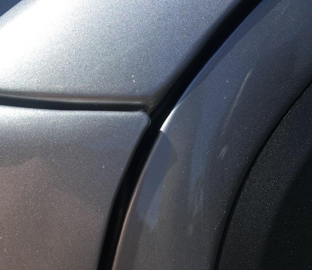

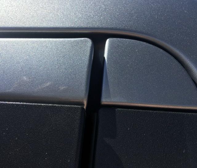

I sure hope the one I ordered is put together better than this. Pic is off of dealer photo via Auto Trader in Midwest.
I know this is old, but I'm sure that the panel that is sticking out is just not installed properly. It's hard to explain, but there a tab the slides in at the top and if its not slid in properly into the little finger/L shaped bracket it slides into, it will stick out.
