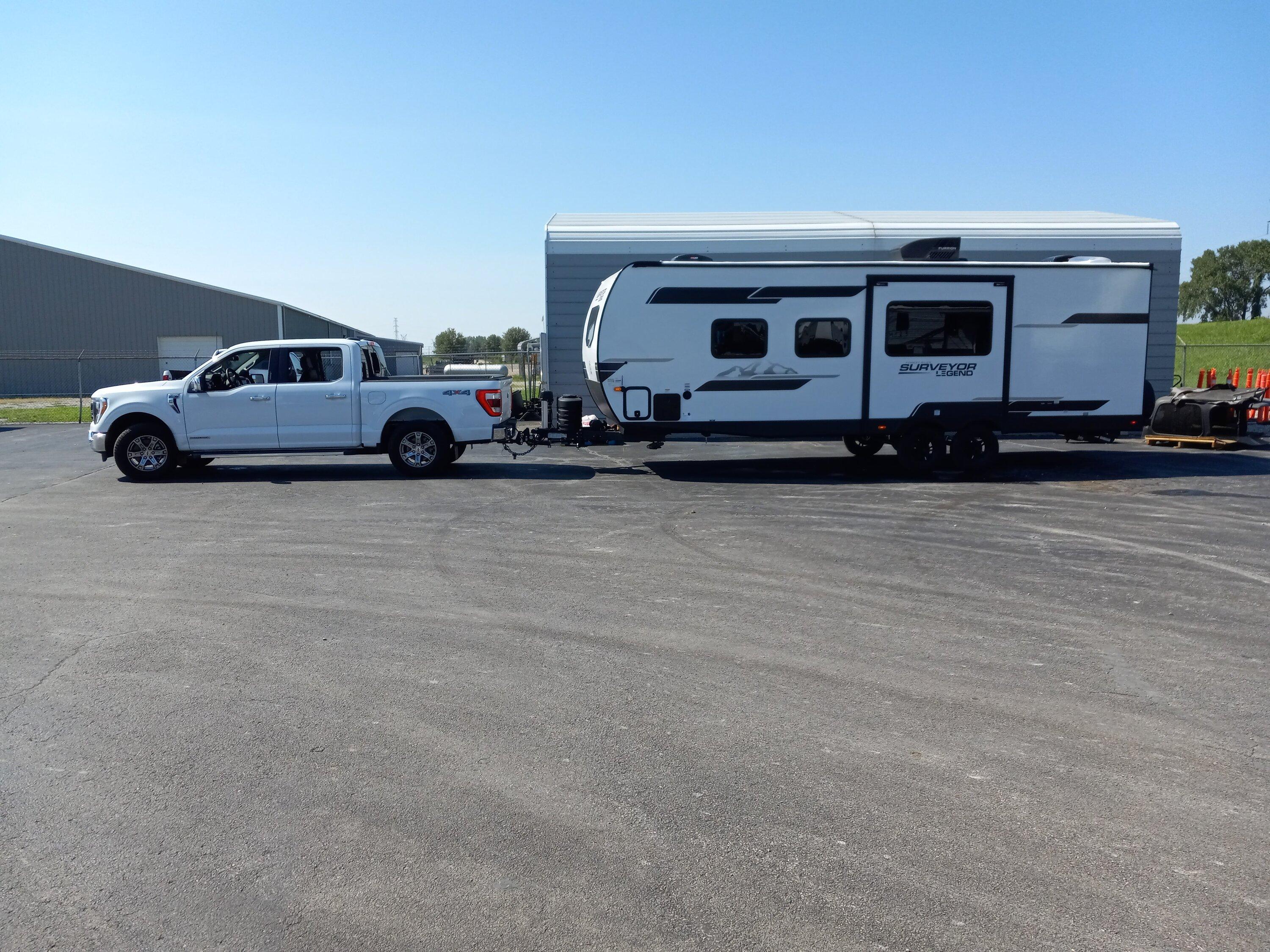

The truck looks fine but the nose of the trailer looks a little high. I'll check it again after I'm finished modding it and it is loaded to go.

It looks perfectly level to me.
Nicely done.
