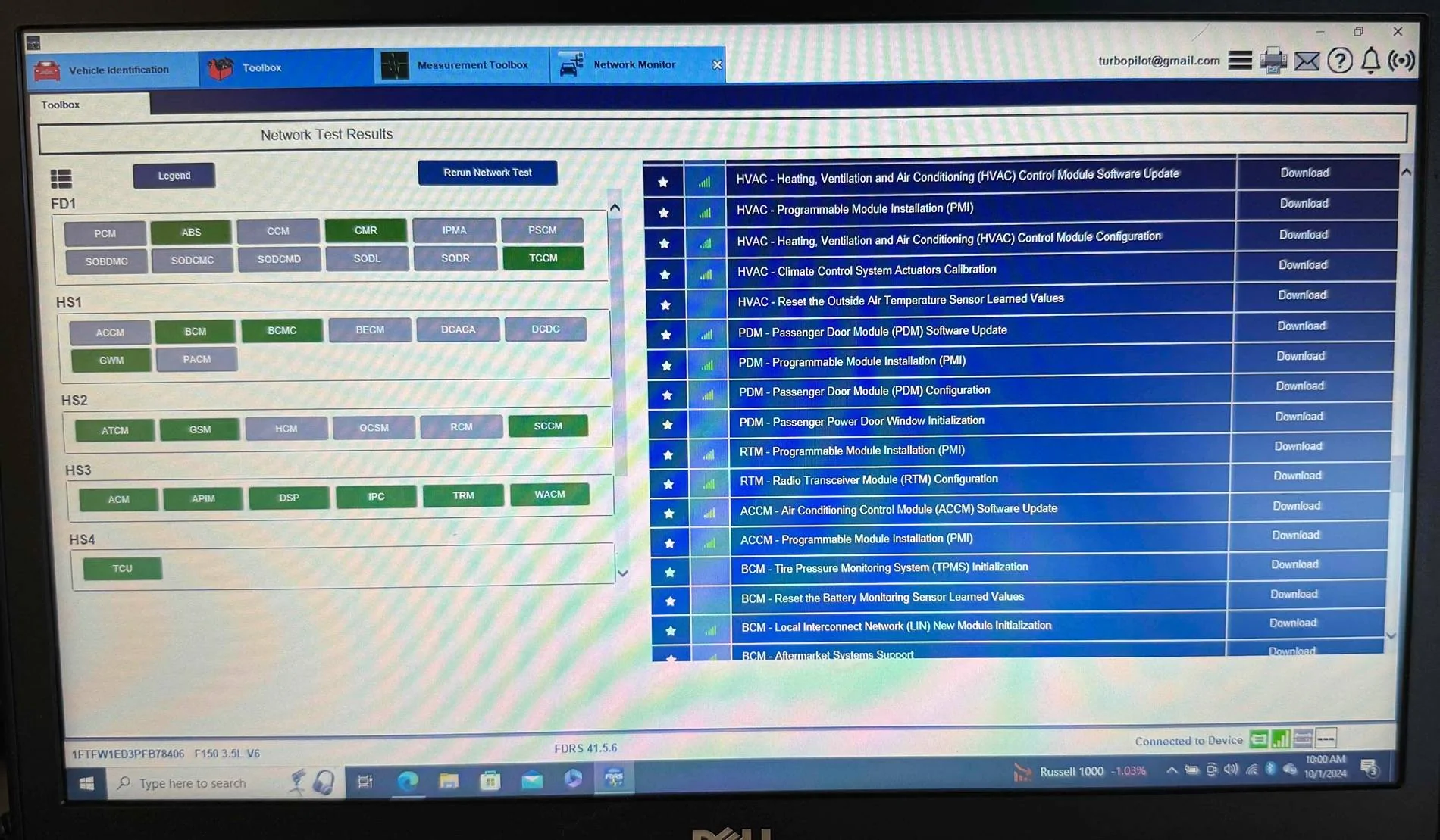

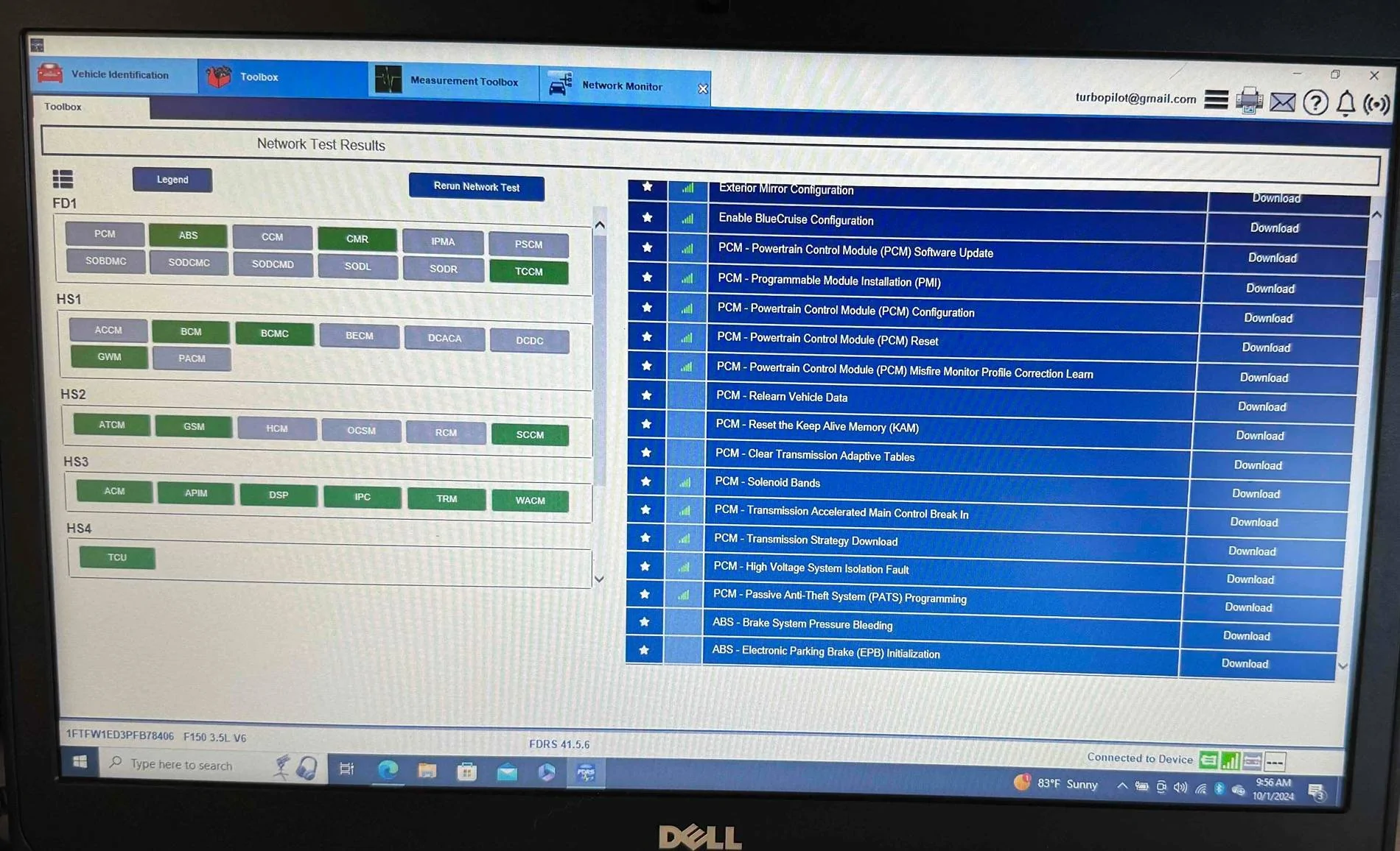

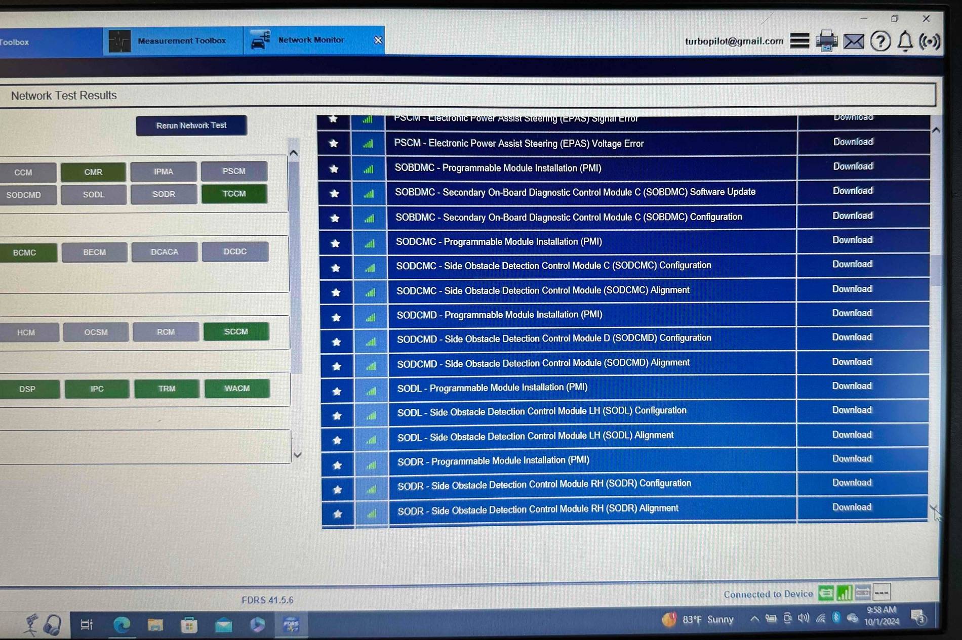

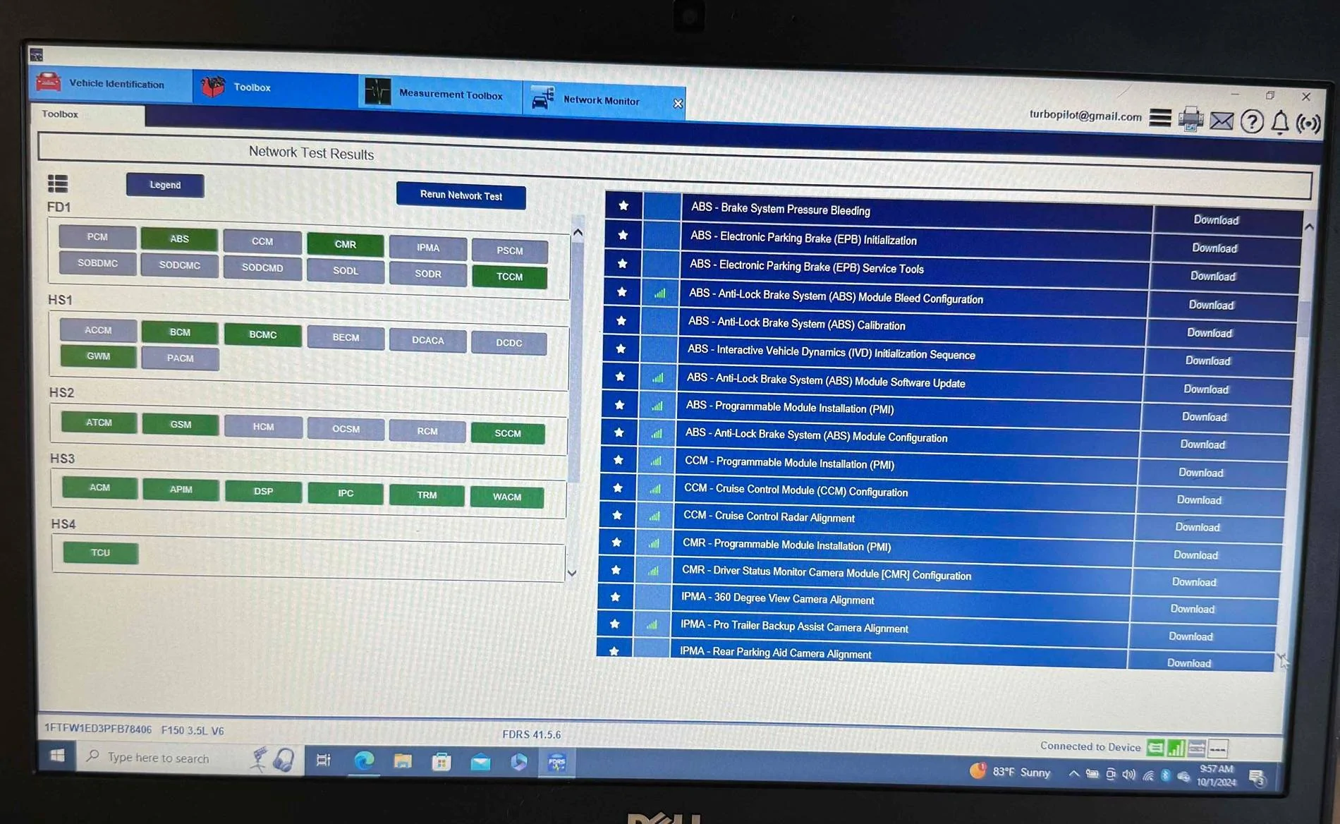

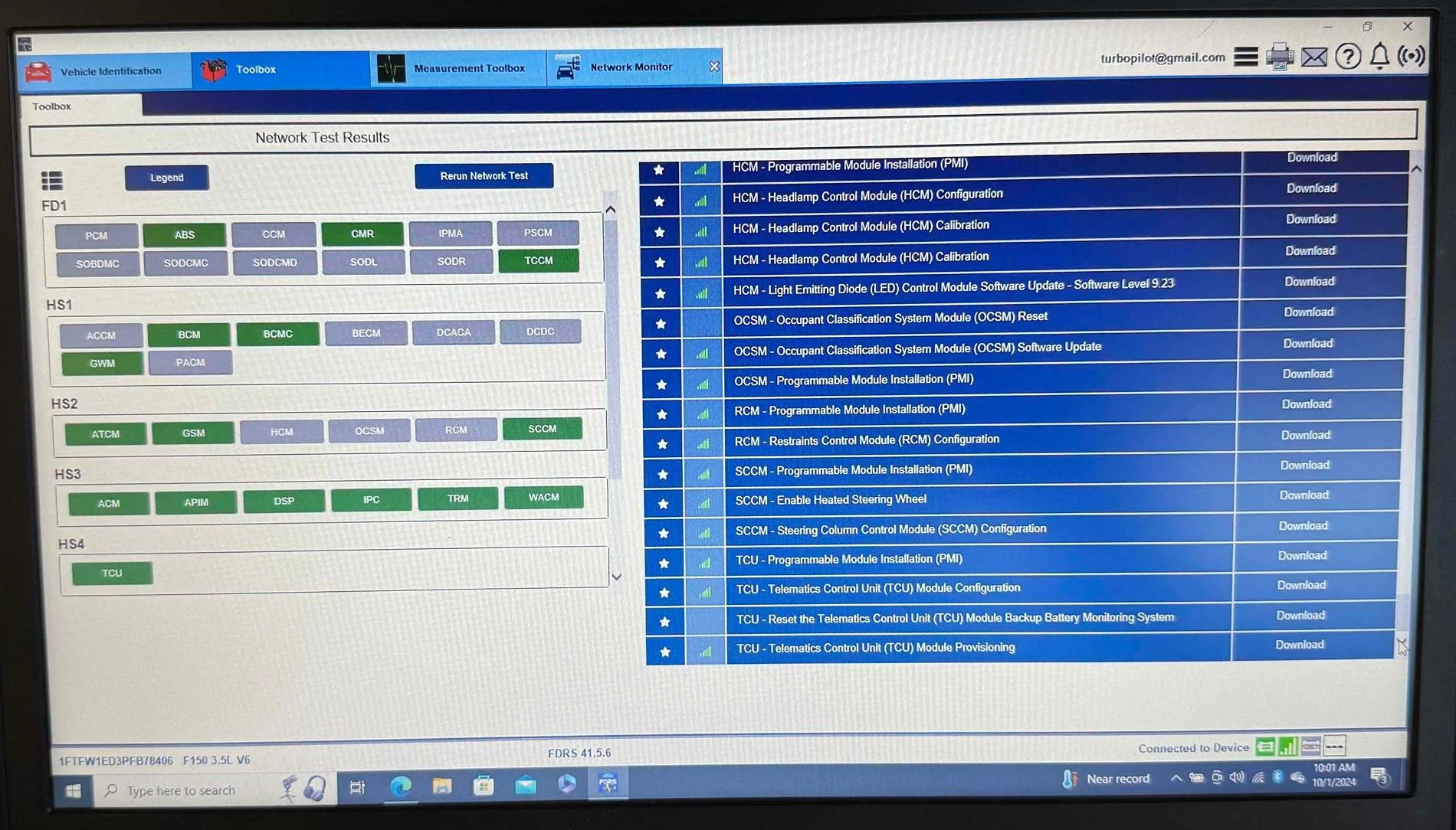

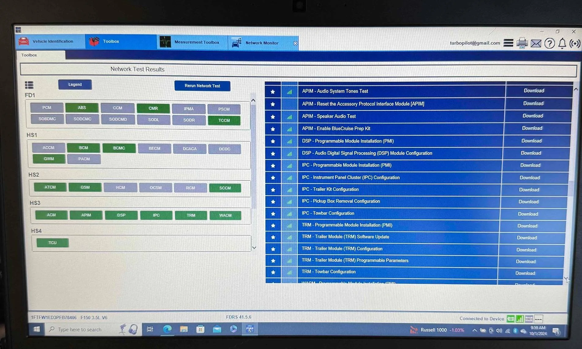

To my surprise I just hooked up my 2023 PB to FDRS and was greeted with 13 pages of downloads with about 221 individual files. I have no idea what this is all about. Before I started the process I thought it best to ask our brain trust "what changed". Thanks for your help. Here are my downloads that FDRS wants me to download.

Click on SW UPDATES tab. You are on the complete program listing.....lol
