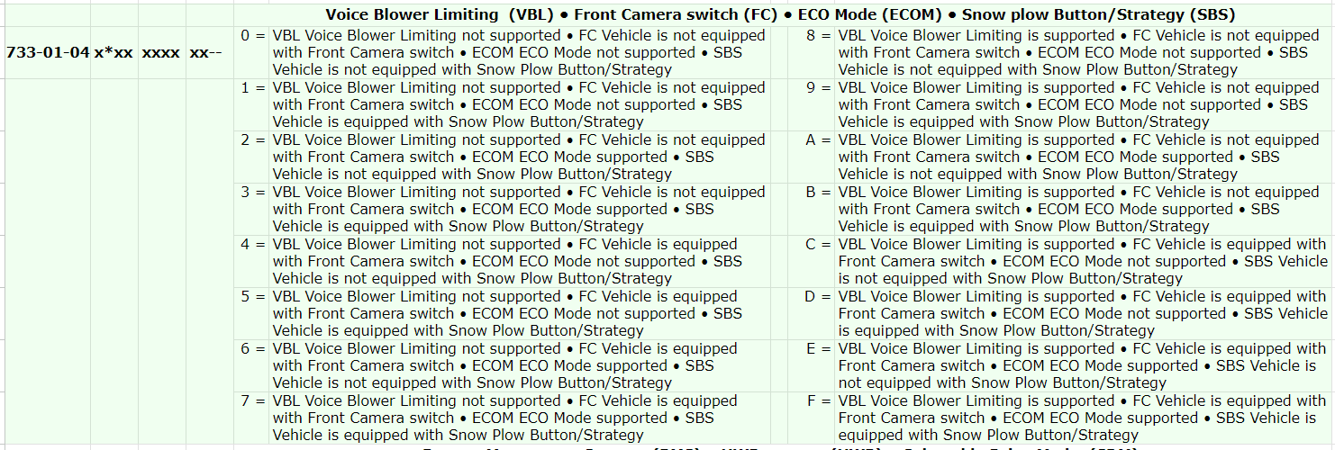

On a side note... any way to bypass the fan turning down when a call comes in? When its 101* outside and you get a call, I still want that fan maxed out... (Forscan edit?)
LOL, quickly turn off bluetooth and wifi and..... wait for it.....
talk on the phone
or play with this variable... You're going to have 8-F at this location, change it to the one left of it.
just a guess, probably E to 6 or C to 4
talk on the phone
Thanks Hamma, @Livnitup any playing around with this you have done?
I'd imagine most people haven't played with it. As someone who's played with too many variables to count in a dozen+ modules, it won't hurt you to try.
