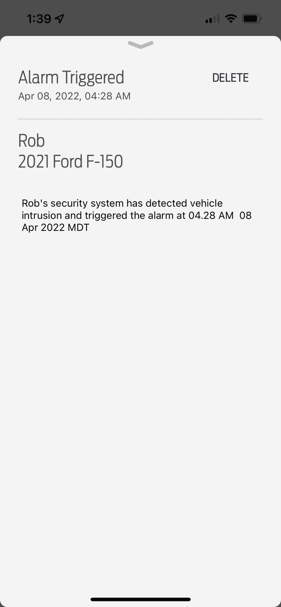

BCM is up to date. The alert I got was vehicle intrusion. Happens whether it’s parked outside or in a garage 2-3 times a week
Yes, your issue is different. I received “hood open triggered alarm” or something like that..
